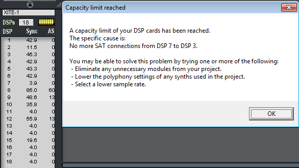

Here's an interesting one. Nothing is loaded on DSP 7, but I have to save & reload to get past this error:

Possibly whatever you were trying to add to the project at the time was trying to load on DSP 7 ?
Re: XITE-1, project can't add midi routing?
I was routing midi...no change to dsp, per se.
Posts: 5055
Spose the question is whether MIDI routing uses DSP or not. If not, then how is it done ?

jksuperstar wrote:Here's an interesting one. Nothing is loaded on DSP 7, but I have to save & reload to get past this error:
Interesting !
