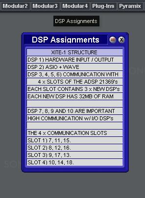

In the little jpg attached, You'll find a summary of the dsp assignment..
I guess everyone's waiting for Scope 6 with a good manual (for all the dsp assignment gas plant) and a more 'automatic' dsp management to use all the power of xite...
DSP assignment.JPG (30.67 KiB) Viewed 6554 times

Bud, check the post above about dsps assignments. 7,8,9,10 are the first dsps of each slot. Slot #1 is then 7, 11, 15. Slot #2 is 8, 12, 16. etc. So the mixers span all slots. the assignment "window" is just a notepad with information Ralf from S|C sent out a long time ago. So you won't find it in the menus ;)
You find the DSP usage meter in Set -> DSP Load menu. By default, it shows the number of calculation cycles, or click the % to see in percent (unused is then 3% instead of 256-400, for slot dsps 7-18, and 38-40% for the older dsps 3-6 used for communication).

B.t.w.,- following advice from Jimmy, JKsuperstar and others here,- I managed to create a new large project for potential live gigging and/or usage of XITE-1 as a "MIDI tonegenerator /pre-mixer & FX" machine in the home studio.
I threw in by automaticDSP assignment:
XITE-1 hardware analogue audio I/Os
AES/EBU source/destination
XITE-1 phones destination
ADAT A source and destination
XITE-1 MIDI source/destination
ASIO2 float32 source/destination modules (4-ch. In for a VST host and Reason6 stereo outs and 2 ch. back to VST/Reason)
2 sequencer MIDI source/ destination modules conneced to MIDI OX virtual MIDI cables/ports
STM1632X (13 stereo channels, 3 mono channels, 4 aux sends, 4 stereo aux returns)
AUX-1: Mastererb Classic
AUX-2: SC Plate Reverb
AUX-3: SC Chorus/Delay
AUX-4: Mono Ducking Delay
I missed a mono>stereo signal splitter in SCOPE 5.1 software to use the mono AUX sends w/ stereo FX stereo inputs,- so,-
I duplicated mono AUX sends and connected both to L+R inputs of AUX 1 - 3 FX.
I someone is aware of any complications using this technique,- please leave a comment because below, there will be a "bug" anounced later.
MicroMixerX, 4 channels stereo for synths not requireing AUX-FX and WAVE Player,- and 8 mono Ins for VDAT outputs
manual DSP assignment:
24Bit WAVE source /DSP #2
VDAT 8-channel out /DSP #2
STS4000 stereo out & 3 mono outs, 16 voices / DSP #9 / MIDI In = seq. MIDI src. 2 / MIDI Ch. 2 - X
B-2003 / DSP #11
Minimax monophonic / DSP #11
Profit-5 poly, 6-voice / DSP #12
Vectron Player poly, 8-voice / DSP #13
DSP#14 reserved for Prodyssey (until I have my key),- mono- or duophonic like the original synth
Lightwave v5 poly, 8-voice / DSP #15
UKnow7 poly, 8-voice / DSP #16
The overall DSP load is ~48 or 49% !
I stopped here and saved project w/ "save as" to a separate location, closed MIDI OX and quit SCOPE 5.1
I unchecked "Save as Startup" before I saved.
