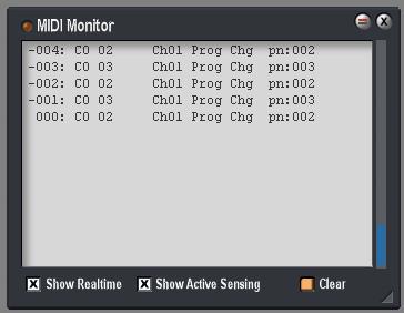

Jimmy any chance you can post what comes up in MIDI monitor when you sending your prog changes to Pro5 ? Probably do with the LSB / MSB stuff you've explained, but gives us something to go on.

XITE-1/4LIVE wrote:Ladies $ Gentlemen...................Bud.
FWIW Mine works, ...
Ankyu Jimmy !!!
Awesome !
It was in deed the numbering of the preset banks,- not only the programs !!!
For Minimax and B2003, it was pre configurated, so I never looked at these details before, also because it worked that way in SCOPE v4 and also w/ Prodyssey out of the box.
It´s NOT pre-configurated in Profit-5, that´s what I had overseen,- damn.
Yikes,- I got it working and I´m happy now !!!

If I have 128 good patches for a "Prophet 5", I´m fine w/ that for a long time.
There's really no need to do this, it's far easier to just create a new bank and save presets there. Or if you really wanted to go down that road, just copy the bank, renumber the original bank as 99 or some number you will never use, and use the copy to save over.
Copying a bank is very simple (sorry if this is teaching grandma to suck eggs). Open the preset list so you have the left and right panes open. In the left pane create a new bank which will be the copy bank. Open it - it will be empty at this stage.
In the right pane open the preset file and open the bank you want to copy. Click on the top preset so it is highlighted. Hold shift and click the bottom preset. You have now highlighted all the presets and can use Preset>Copy.
Now move to the left pane and hit Preset>Paste and you get all the presets copied over. Occasionally you'll get the irritating ":1" tagged at the end which is supposed to signify a duplicate name or something, but it's very inconsistent. I just delete it manually from the name. Now save the bank of course.

Mr Arkadin wrote: I think maybe you hit the 'sort by name' or 'sort by category' tabs just before hitting Autoindex (or just after) -
Thank You Mr. Arkadin !
Very usefull !!!
When I used SCOPEv4 and the PCI card,- I never thought about using in realtime,- so I changed my patches manually always.
Now and w/ XITE-1, that changed.
thx again
