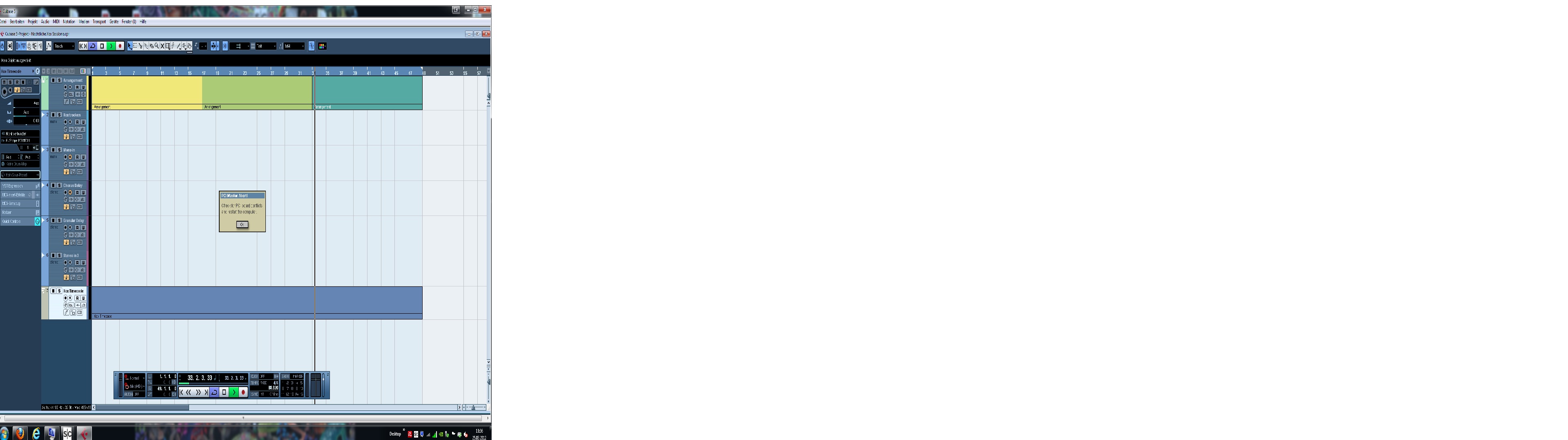

The Powerpulsar is now installed, but now i keep getting "PCI Master Abort" messanges when opening scope.
It was ok before when i started a project for about 1 hour.
I want to see if there is a problem with shared irqs but dont know how and where i can see this.
Cheers

Re: Driver for Powerpulsar 15 DSP
post a screenshot of the message please.

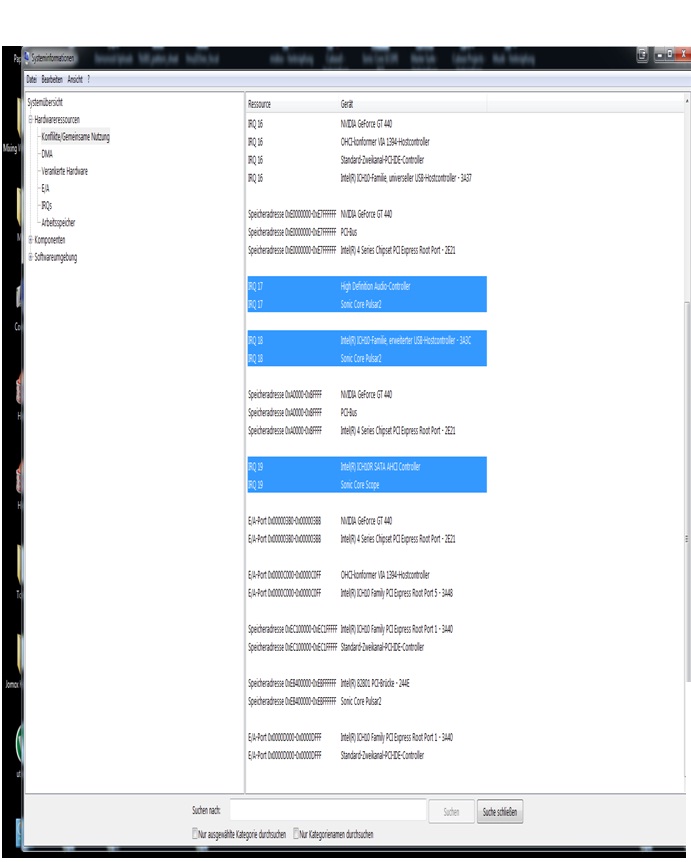

Dati
Posts: 73
Joined: Tue Mar 08, 2011 8:59 pm
Post by Dati »
Hi,
Here are the error message and the IRQ sharing. I disabled the USB whoes sharing but without luck. I dont know if i should try to dissable the Intel SATA Controller too.
I have this Motherboard: http://geizhals.at/528332 +Win7 + IntelCore 2 Quad CPU
PCI Master Abort!.jpg (306.05 KiB) Viewed 3015 times
IRQ sharing.jpg (96.41 KiB) Viewed 3015 times
ok, disable USB controller 343C in the device manager.
also, disable the onboard audio, preferably in the bios, or in the device manager, if you intend to use it when you're not using Scope.
that should give you a working system.
Dati
Posts: 73
Post by Dati »
Thanks gary,
i dissabled the USB and the onboard audio, but i got the same error now.
Is it possible, that heat is the cause?
I think with 3 boards i should get a fan, do you know a quiet and good one?
Cheers
