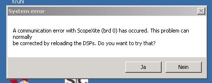

hello,
FYI: I am posting for a bandmate ...
New PC -> ASUS P8P67 Rev. 3, i7, 16 gb ram, 3 hd's, graphics card gigabyte hd6700
Old Scope 15dsp card did work -> pci bandwidth limit reached ... nothing helped ...
see also this thread http://forums.planetz.com/viewtopic.php?f=19&t=30557
ordered XITE 1D ... installaion/aktivation went well ... when scope 5.1 is being started an error message occurs ... click ok -> then I can use xite ...
when inserting some new hw-modules (adat source for a16 ...) a lot of error messages are displayed .. see pics ... really annoying!
any hints? seems to be a irq issue ... new mobo? I don't wanna get a new processor too ... would like to use all components I've bought so far ...

Have you removed the old PCI 32bit card.....?

Scroll to the bottom of the 'XITE-1 Installation & Tips' section here, where GaryB gives a fix hint for this error :
http://www.hitfoundry.com/issue_09/xit_mast.htm
Worked for me. And I didnt have to uninstall the PCI boards (still using 'em).

yes, removed the old pci-card ...
will try garyb workaround right now ...
thanx so much for trying to help

OK, changed cset.ini ...
no error at startup ... but after a few seconds .... error copy protection violation ... and then error communication failed ...

Hi all,
some more info:
updated to 5.1 version of scope for the old 15 dsp-card after for the new pc ... as I mentioned eralier ... scope card and 5.1 software didn't work (pci bandwidth problems).
so we decided to get an xite-1d and return the old scope card to sonic-core.
after receiving xite 1d we pulled out the old card and inserted the express card.
prior to installing the scope version for xite -1d we made a backup copy of the original scope folder then did an uninstall of the scope software.
after that we did an install of new scope 1d version (dvd that comes with xite -1d). everything went fine ... copied the 2 files manually as recommended in the installing instructions. then we imported the keyfile ... OK.
so far so good. but then this weird error occured when starting the scope software (communication error).
fixed that with manipulation of cset.ini like garyb recommended.
disabled nearly "everything" in bios and os (win7 64 bit). no energy saving at all ...
we also had an error called 30 hardware detected ... could not connect to scope hardware ... but that dissapeared aftre rebooting ...
it's not my hardware so I have to drive to my friend location to check if we can get things sorted out.
I think it is a mobo/graphics card issue ... checking the registry for old scope entries is a good recommendation. mabe I should uninstall the whole thing do a fresh install of scope xite-1d softwware. before that deleting all scope related entries maybe this works ... is there anyone out there using a ASUS P8P67 Rev.3 with xite ... just curious ....
will keep you informed ...
thanx again for the advices.
greetz
tom
btw.: I am located in Stuttgart, Germany.

Re: HELP! XITE communication error
that sounds like either a bad hdmi cable, or power saving settings in windows that need to be disabled. is the XITE sharing an irq with anything?
hi garyb,
- used 2 hdmi cables (the one from that comes with xite and antother one) ... didn't help ... will use another one this evening ...
- I have already disabled all power saving settings in windows and imo the error message would not pop up that fast - only if something goes to "sleep"
- irq is 18 but I didn't check out if this irp is shared. isn't it true that if so there's no chance to have xite it's "own" dedicated irq. but I'll check that this evening ... if the irq is shared then I try to disable the corresponding device ... hopefully nothing important ..
btw: in that mobo are 2 pci-express slots available I could use. unfortunately one is totally covered by the graphics card (sitting under it) so the only possibility is to use that one cnext to the graphics card.
tom
