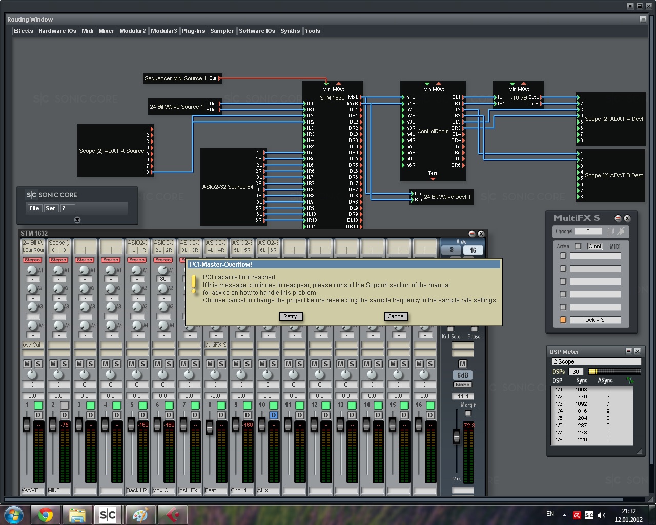

Hello,
I have a weird problem and I'd appreciate much if You could help me with it.
I have a simple project (see the picture one wave source+dest and 6 ASIO channels linked to 1632),
sample rate is 44100, get to the point - the simplest project for my home use ))
When I try to add even MultiFX (not even reverb or optimaster) it says DSP limit reached.
This has NEVER happened before!
I have two Pro cards linked with 5 STDM cables. I tested 2,3,4 and 5 STDM variants - the same result.
I assume the main problem is I went to Windows 7 x64 instead of Windows XP x32 but how can I solve it without changing Windows?
(*upd: I have also a new motherboad - asus p6z68 deluxe instead of msi p45 platinum)
Thanx for Your help.

- SC_Issue_01.jpg (381.19 KiB) Viewed 3626 times

Re: What wrong with DSP usage?
did you do the basic optimization for your mobo?
find them in the tech section
to get some more details: start from a blank project (no module loaded) and load as many masterverb you can (the so called masterverb test).
