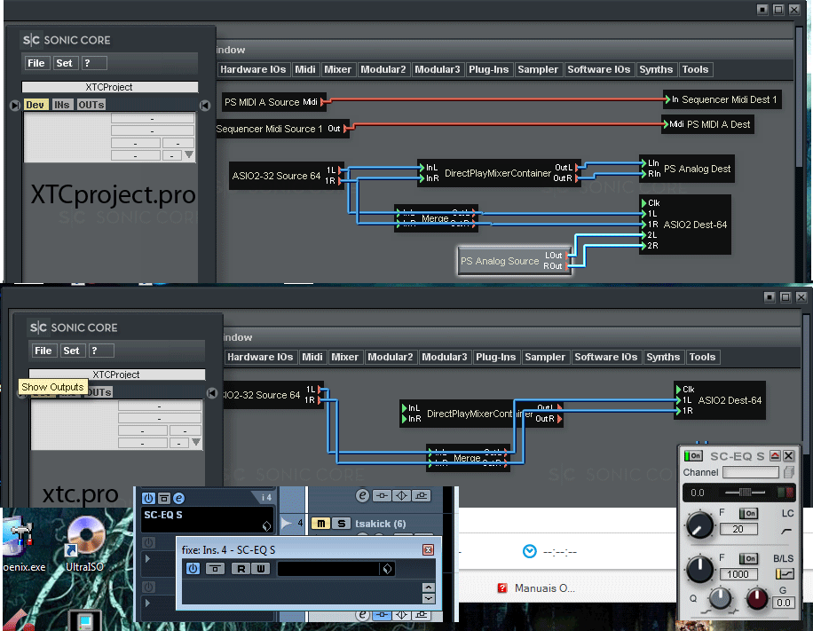

when i try to load a insert in cubase the window plugin loads buts thers no Knobs or image
it loads fine in sonic core software
I attache a file with the problem and my xtc.pro and xtcproject.pro ,
Creamware scope Home , Msi i5, win7 64 and cubase 5 32,
software 5
Thanks

This happens to me as well. I have however discovered that some of the XTC plugs that behaves like this will open ok in the XTC FX Rack. Try loading that first as a plugin and then open the XTC plugins in the rack. Most will then open with the proper GUI.

Ok all works fine on XTC :)
excpte the presets midi maps ,no memorize in cubase
i play a few days in win 7 64 and all works fine ,
excpte cubase and scope have differents delay with differents midi channels .
and the xtc mode the plug ins load rigth but i dont have audio out on asio driver (i have a Boost card) and power sampler and a luna
then i go play on win 7 32 to see
All GREAT on xtc.
the differents delays (normal mode) still happend with diffrents midi channels
the prests problems still
Thanks for the help and replies
