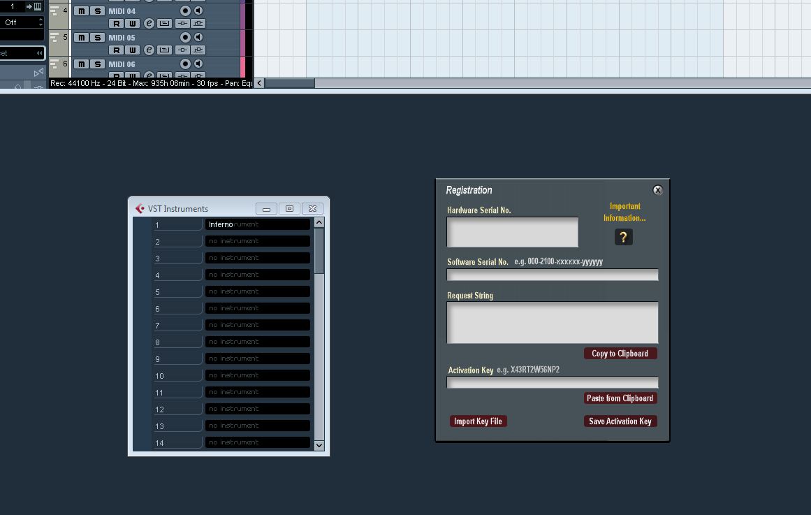

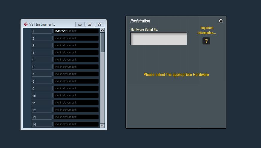

I followed the mail Sonic sent me. They gave me a keyfile for Scope, so that's the first I did, installation of the soft. Scope card found, program installed and Asio driver seen in Cubase, so far so good. Than I followed the instructions to install the plugins that came with scope into Cubase. Didn't seem difficult, typical install in the Cubase VStplugins map. But than the misery started. First time it scanned the VSt's as it does with third party stuff as well. It would than creat a Scope PCI mape under my VST instruments. Problem is any time it found a plugin the Scope registery windows opened. The guys at Scope said in their mail to ignore this and close it ?! So I did like 100 times. Next time I open Cubase it stops (crashes) at the first plugin scan. I have no idea why..
What I found strange:
Any time it asked for a registration of a plugin I had no idea which key to use. the one I got was for the Scope,
and even tried it, no good. Aslo strangen there is a fisrt field that says serial number of the hardware, but that is just empty? Like my card is not seen? But it does work once Cubase starts, Scope Asio driver is working and I have my ins and outs. I manually remove the Scope PCI folder so at least I can still start Cubase. But it annoys me buying an upgrade version that in the end wouldnt give me more functionality than the previous version. The integration of VSt's would me a nice asset. But as it is now just not working for me. If anyone had the same experience please let me know..

Both crash and gave the same registery windows on every plugin found. So I have the feeling it has got something to do with that question for registering. Cubase on both systems runs without problems if I remoce the Scope folder from the VSTplugin folder.
In windows 7 , I could actually see the VST folder and tried opening like Bluesynth. Cubase crashed immediately on a serious error. Cubase log file has a lot of mombojombo, latin to me, but I do read many times "acces violation"..

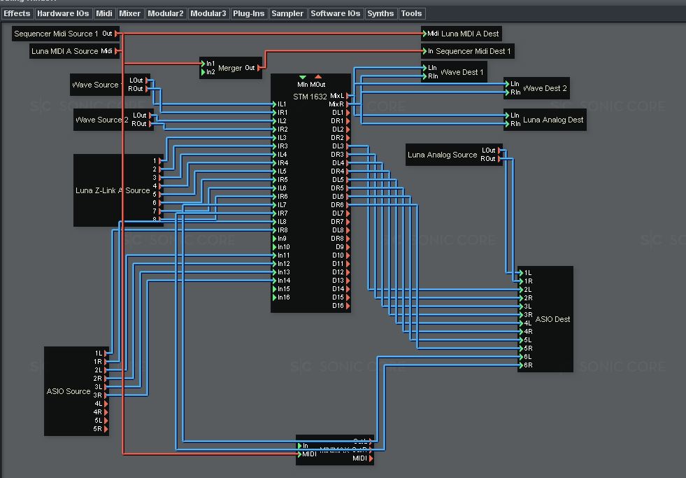

What I did is adjust the XTCproject file, didn't change the name but did my own routing scheme like in example. I enabled XTC mode AND I closed Scope.
Started Cubase and yes the plugins are nicely there and effects and synths starting. No more asks for a key and no more crashes. GREAT !

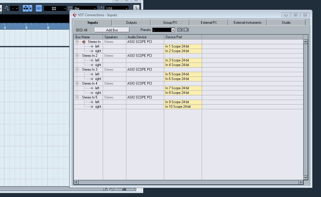

BUT, I can't seem to get my audiobusses connected. I have no analogue source in nor out. I can add busses in Cubase , and the output bus also seems to be ok. But no sound is coming in from my extrnal desk or Z-link and no sound is coming out from the Luna card, so something is still not ok.
The thing is when I do start scope and open the XTC project file I immediately hear my soundcard kicking in, in other words it does all work properly when Scope is open. When closed it's simply not (I also hear the sound card disconnecting, a synth that was playing via Z-link closes off). What I would expect is that Cubase opens this correct project file somewhere in the background so the soundcard kicks in again, but it simply doesn't. Asio Scope is properly selected in Cubase and I do see in and out busses from Scope. For me it feels like it didn't accept the routing scheme I made within the XTCproject file or doesn't open it the way I made it. If this could be sorted out everything would be 100% for me.

the19thbear
Posts: 1499
Location: Denmark
Re: Cubae 5 crashes on loading VST's Scope 5.1 in XTC
Post by the19thbear »
For testing purposes, it's good to leave scope open and load the xtcproject.pro setup.
Then open cubase (yes this is NON xtc mode:). Test your routing etc to see if you have any sound I cubase and see that everything behaves like it should.
When everything works - routing wise - save the xtcproject file and close scope and cubase.
Open up cubase again this time in xtc mode and select the right asio driver (setimes you have to select it again, because the daw wants to connect to the old one, but need to be told that is a new one... This is sometimes only though)

Thats what I all tried before. The last scheme I sent does work when scope is open, so i save this as an xtcproject with xtc enabled. I close scope and open Cubase and this time no sound. I do see asio sources getting in to Cubase channels. That is to say, if i use a softsynth and i play on a keyboard with sope midi in i do see channel activity on the softsynth channel, but no sound going to the soundcard analogue out.
So for me asio and midi seem to be ok but hardware sound in and out are not.
I will try some other settings later this week. For me it seems the analogue ins and outs don't get enabled when i wanna work in xtc mode, cubase does see ins and outs from the card but somehow they are not getting routed properly, and since i have to keep scope closed in this mode i also have no visual control on the scope part.

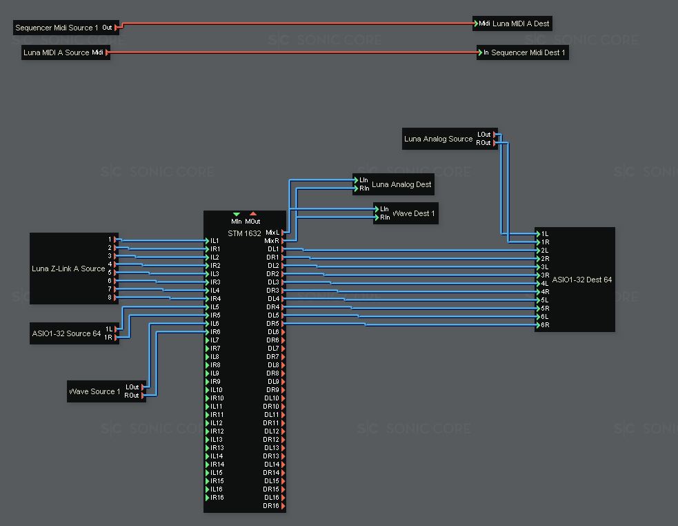

Second: since I don't give up that easily I found an hour time today to do some extra troubleshooting.
Here are my "personal" conclusions on XTC mode. I decided to start a basic Scope project, just do the midi and connect an Asio or soundcard in directly to the soundcard out. No mixer loaded. Saved as XTCproject and XTC enabled. Closed Scope started Cubase and sound is nicely heared at the soundcard output (from Asio, VSTi and from a hardware synth going into soundcard in).
Then I did the same, but I placed a small mixer between the signals , that micromixer. Just enough to let go in the soundcard in + and Asio source , mix out to the soundcard out. Saved again same way and closed project. Opened Cubase, I see a fast XTC windows coming in , micromixer getting loaded, but my problem remains, no in to the micromixer coming through and no out to the soundcard, so I hear no sound.
Then closed Cubase, opened same project again , disabled XTC mode, left Scope open and started Cubase. Everything works just fine now, I have sound.
My conclusion : Or I have a configuration problem or Cubase simply doesn't see the Scope routing once there is a mixer involved.
Solution that would work for me but unfortunately can't do. Perform direct connections in Scope without any mixer, but like I said impossible. That would mean for example connect directly an Asio and a luna analogue source to the Luna out. Problem is, the Soundcard out only accepts 1 connection at its in at the same time. So the only way I see to solve this is working with a mixer and connect the mix out to the soundcard out, this is how I normally work without XTC..
So I see not other choice than stop wasting my time trying to get XTC the way it should supose to work for me and stay with the normal Scope routing. At least that way everything works the way it should. Unfortunately I have to accept I can't have Scope VST integration in Cubase, but I can live with that since I have other gear for that...

the19thbear
Posts: 1499
Location: Denmark
If the micro mixer is called micromixer.dev make a copy of it and rename it to micromixer.mdl
Open scope and your xtcproject.pro and delete the micromixer in the routing window. Then insert the new micromixer.mdl in the project instead (you can drag and drop it directly from a normal windows window - that way you make sure that you. An see that you are puttin in the mdl file and not the dev file again.
Save and quit.
It should work now:)
