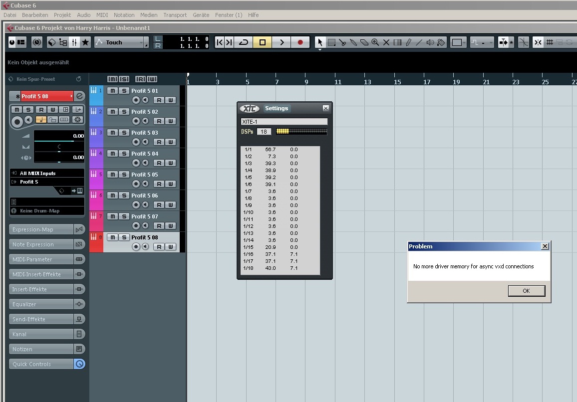

Hi!
I have this nasty error message when I work in XTC-Mode (VSTi) in Cubase 6.0.5 32 Bit PC.
This problem appears when a certain amount of Soniccore gear is inserted in my Cubase Project.
Then it's game over although the XTC-Load displays only apprx. 20 %.
So what can be done to load more devices??
Has it to do with the XITE-1 or with the PC configuration.
Do you need more info about my PC?
Reinstalling the SCOPE Software brought no success.
SC Xite-1 with latest Software
Win 7 32 Bit all updates done
Cubase 6.0.5 (latest version)
INTEL DP35DP Mainboard with QuadCore and 2 GB RAM
Any help welcome
Thanks
Harry

Re: "No more driver memory for async vxd connections"
i'm sure the XITE can load more devices than the software/hardware environment will allow. everything has a limit. that's just my guess.
in Scope mode this wouldn't be an issue, but with the massive amount of communication involved with integrating into the sequencer, there is probably a limit imposed by the system itself.
Can you post a list of the devices / sample rate / synth poly and DSP meter (if XTC mode has one ) ?
Ok. I will post it.
I also guess that this problem started with Cubase 6.0.2 or so.
With older versions I didn't have this problem.
I have to figure out how a fallback from 6.0.5 to e.g. 6.0 works. It seems not so easy for
I can't execute the 6.0.2 update-installer because there is a message which says that
the current version is newer than the one I try to install. So completely uninstalling Cubase and starting
again with an older version could be an option ?!?!?
Harry

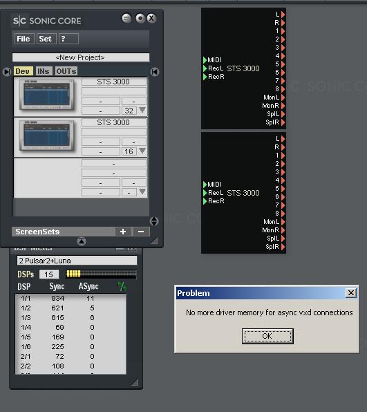

Bumping this as I am getting this error as well.
I finally reinstalled V5.1, and this error appears in Scope only mode after adding a second STS 3000 sampler or using more than 32 voices for one STS .
Thing is I was able to run two STS 3000 in Scope 4.0 with no issues.
I also tried this with no other devices running in SFP mode(I don't use XTC)
Win XP sp3
2 Pulsar II & 1 Luna II
3 gigs ram
Scope v5.1
Win XP sp3
3 gigs ram
Scope v5.1

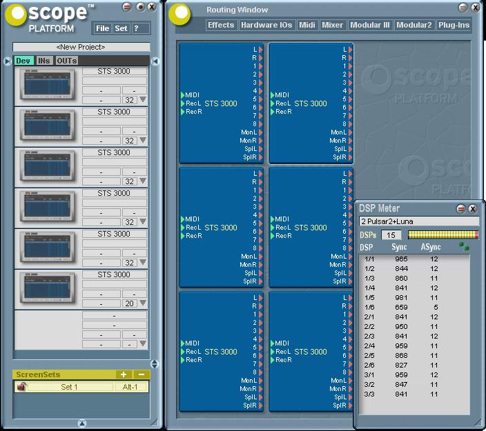

- SFP V4 loaded 2 sts 3000 with 32 voices each with no problem
- uhoh.JPG (40.75 KiB) Viewed 4137 times
Something has definitely changed between 4 and 5.1 in regards to this error. I reloaded 4.0 to see how many STS 3000 I could load on my cards and here is the result...
On 15 DSP's Maxed:
5 @ 32 voices
1 @ 20 voices
On 15 DSP's Maxed:
5 @ 32 voices
1 @ 20 voices
- hmm.JPG (82.85 KiB) Viewed 4102 times
This issue appeard suddenly. No change of SCOPE 5.1 Software (I had the latest version installed when it was working well).
Then this error-message appeared
Probably an hardware-issue??? Will there be the need for a firmware-upgrade of the hardware??? Any counter???
I can't go on with this issue it kills my creativity.
I use SCOPE mainly in Cubase XTC-Mode (Cubase latest version 6.0.5 PC, WIN7 32 Bit)
Harry
Harry

I've posted now a screenshot with this problem!
I've added 7 Profit-5's (1 voice each) and with the 8th there is this message.
Is it related to the XITE-1 Hardware or to my PC-Hardware or to the PCI-Express-Interface?
Cubase 6.0.5. 32 Bit Win7
Intel Core2 Quad CPU Q9450 2,66 Ghz
INTEL DP35DP
INTEL DP35DP

This seems only related to Scope 5.1. I have neither cubase or studio one and recieve the error when using Scope 5.1 standalone with no other software loaded. No such error in 4.0.
Same here!
Gets the same result..

May I ask which accuracy you ran on your 32Bit system ?
Did you check 32Bit or 64Bit internal accuracy in the preferences/program options ?
I myself I checked 64Bit accuracy and that might have caused crackling and nearly 100% processor load w/ one of the demo projects coming w/ Studio One v2 Pro,- and I have a older dual core machine too, 2x 3.86GHz, running Win XP 32Bit SP3.
Not sure the question is for me....
if yes, then;
For the moment I didn't really play with the bits. I am just trying with 1 project where i didn't modify any of the default settings.
When I look in the preferences, all i see is "32 bits" (which is Scope's bit depth). I have w7 pro-x64, i can run 64 bits plugins fine (no difference with cubase 64 bits)
My system is based on Scope pro PCI with Scope 5.1 on w7 64 bits , very sensitive to PCI overflow issues and currently limited in term of asio outputs (as the mobo is recent, it does not handle PCI as well as 5 or 10 years ago).
I cannot tell anything about XTC as I don't use it.
On dsp/native development mailing list, many people who seem to know what they talk about, say that 64 bit accuracy does not bring anything soundwise except for marketing/advertising purposes. I don't know if this is absolutely true, but having attempted to read their production in articles and blogs, highly technical, i'm enclined to think they could be right.
My point was to (advertise for studio one, lol) , was to point out that Studio One is more solid than cubase on the same hardware pc/soundcard at same bit depth/sampling rate. and so may be there were chances that it solves some issues.
Mehdi
ps, that's what i have as preferences (pic below)
ps2 it does not crash when starting and scanning my /vst_64/ folder.
