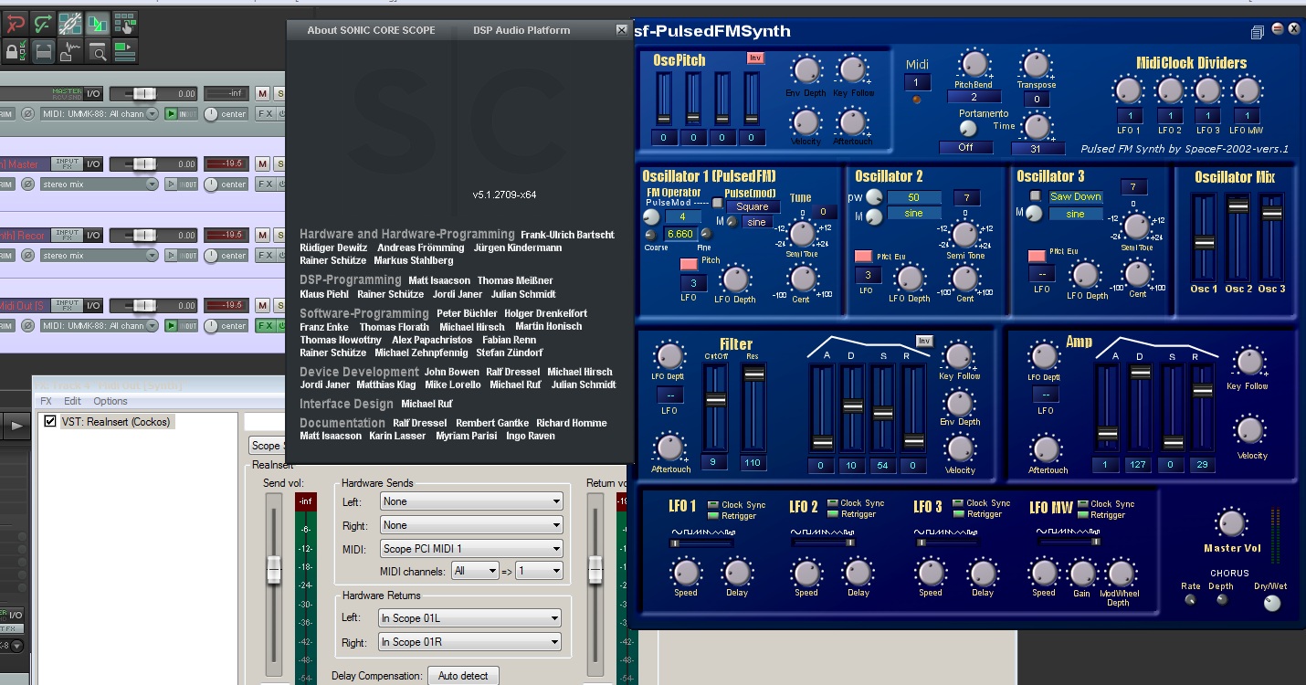

lg widy
Re: Old Plugs still work on Scope v 5.1.....?
sf-PulsedFMSynth11a..dev
i wonder what is that
really can't remember
- was it working in scope "pre 5. " ?? (i ask because all the FM stuff i have are still working for me, that's why i think it could be buggy from the start, not because of a compatibility problem, but i can't be sure because i don't remember that dev (there are a lot that i don't remember anyway
and it is working in XTC ??? weird...
(PM me a pic of the dev if you can please).
- Synthetic-r3.dev : could be buggy, because the later version work fine here (just pulled SDX and DXD, which are built on the same structure, so i guess the R3 has something wrong in it, unless it worked fine for you before)...
i'd be interested to know.. may be i can detect a particular module or something that has became outdated/uncompatible and should not be used anymore...
EDIT: oops, it's a list of what is working... i didn't notice
glad to know these old stuff are still running...
pic here
i tried almost all free and scope synths .. this was one of some hard day in my life to create all the dll's and xtc.ini files ... wah ... maybe i made some mistakes on renaming
and i lost some synths but i think it will not work .....
lg widy
lg widy
- sf-PFMS.jpg (361.3 KiB) Viewed 3686 times
lg widy
ok , i think i remember now....
thanks a lot....
i think i have to search deep in my archives to see what's up with it....
thanks a lot....

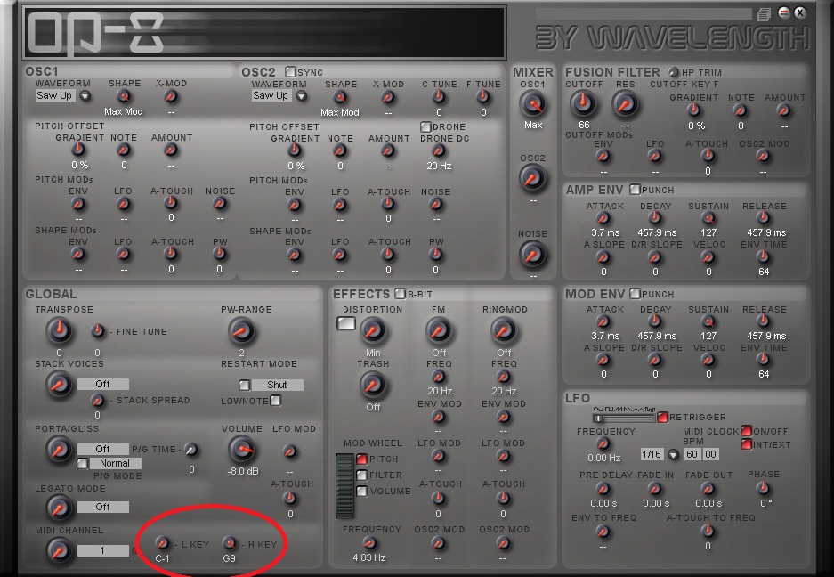

Wavelenght OP8 does indeed work under 5.1 - but refused to output sound probably due to a missing preset file.
Somehow seemed to set the upper note limit to something unreal.

OP-8 is silent and I have the preset file. All other wavelength synths seem OK.
You should play with the high limit / low limit settings for keys by the midi settings. As Astroman mentioned there is something funny with the function of these (regardless off having the preset file). I confirmed this on my PCI system that the octaves are one off (a high-cut setting of e4 would filter out an f3).Mr Arkadin wrote:Here's some observations (Scope 5.1 in XITE-1):
edit: Just to clarify, this is the default setting and doesnt work. adjust the H-key down and it will come to life.
yeah, I'm really really happy that it's working again - one of my favourite synths.
and once I get along with the Lemur Control surface, it will be one of the most mad ones around
