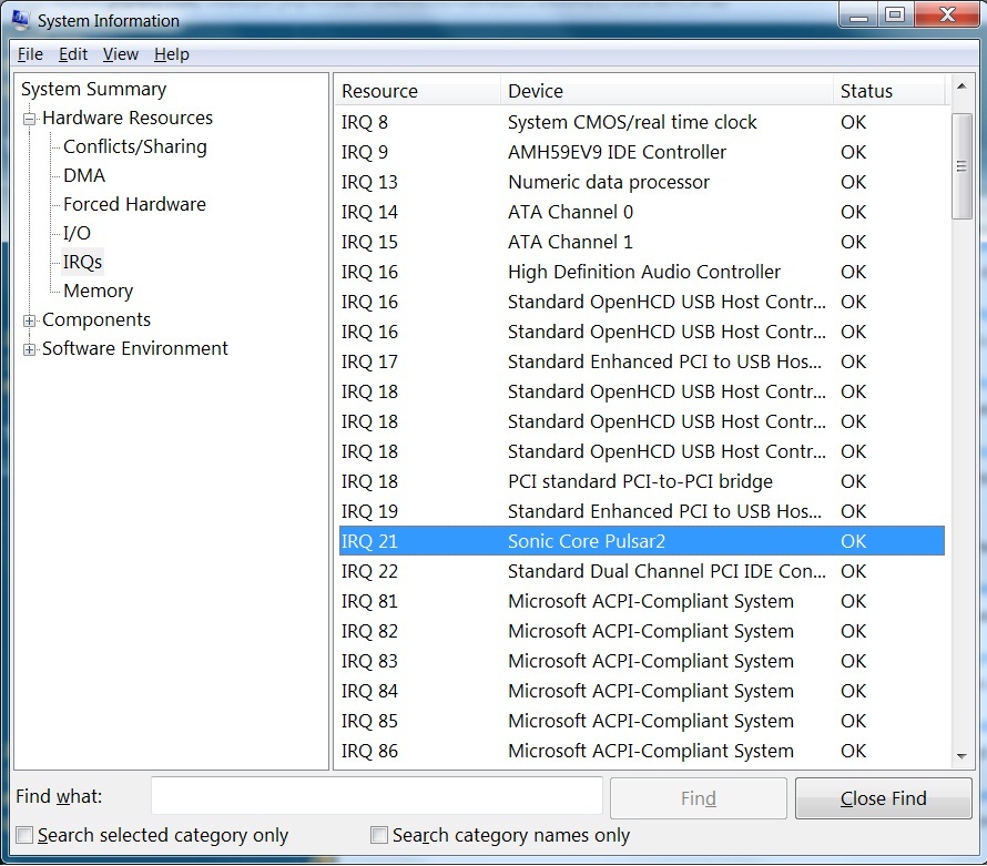

also, is the card sharing an irq with anything? if so, what?

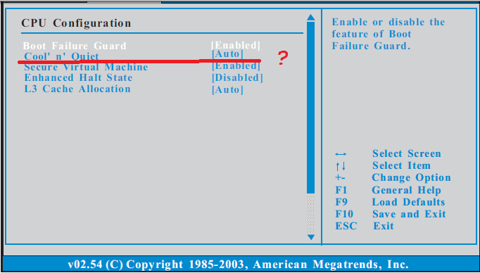

1.) Is it Qool n' Quiet option in BIOS?
2.)By looking at the IRQs list, it seems that Pulsar doesn't share his.

yes, cool and quiet.
the way that that works is that the cpu is only partially powered up normally. that's why it's cool and quiet. when there's a load, the power ramps up in stages. the thing is that realtime audio requires the cpu to ALREADY be powered up. disabling that feature just means that you have full power at all times.

Well, I turned it off in BIOS and yes, no more pops and crackles during playing audio.
So.. problem solved, I guess.
