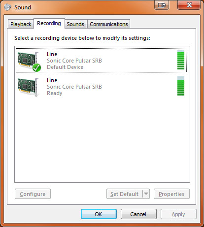

The topic of the day here is my Wave Dest software inputs are so noisy they're not usable. For the most part when I'm using SONAR, it's not a big deal since I just default to ASIO. But when that's not an option for whatever reason in Finale, Sibelius, & StroboSoft due to crashing when ASIO is selected, I am left with using Wave IO of SCOPE.
Playback does not have any issues but when I need to use input (for example to use StroboSoft to tune my guitar or something), I can't use because the noise is too much.
Another interesting note on the problem: on these Wave Dest devices, left channel is picking up all the noise & right channel picks up nothing, no input, no noise, just not working at all.
Anyone else ran into this issue in Windows 7 x64?

there is a problem with the wave source in 64bit. it has slight and random crackles. both l and r work fine here, though. the issue i described is a known one. it'll get fixed.

I have exactly the same problem, well, it seems we r waiting new scope update, I hope I won't be too expensive B-)
