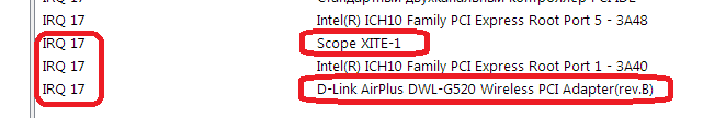

If I disable WiFi clicks disappear.
- irq.png (6.99 KiB) Viewed 4511 times

Re: wave source random glitches
duh...
realtime audio can't wait for the wireless that is constantly polling and so uses it's irq every single time it comes up.
you'll either need a different adaptor or move it to a different slot or disable it when you do music...
