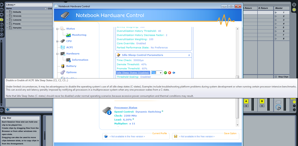

Anyway, I've been experimenting on the old MBP plus XITE, right now I'm installing Live to see how it works, I figure I might as well get a good image of what this system does do before I get hypnotized by numbers.
The heating issue seems to be common in these machines... I just get a bit nervous because I already made some DIY interventions (with success), but am always afraid I left something out
... It's controlllable under OSX using some utilities (SMC Fan Control), and for windows, there's a program called Input Remapper that allows tweaking the fan speed and other stuff.
There's another program called NHC (Notebook Hardware Control) that allows further tweaking of the system. This free Beta version lets you disable all sleep states for the CPU, at least on this CoreDuo. Maybe it can work for i3/5/7 too, and override some locked BIOS settings I hear about in some laptops (VAIO, for eg.)

- NHC.png (181.53 KiB) Viewed 2778 times

Well, this is weird...
I managed to get the heat under control on the MBP, when using OSX. It boots at 35 C, and never goes over 65 C. I tweaked the fan to kick in a little earlier, and it can manage the lighter Live projects (mostly audio clips and a little FX) with ease. It does get hot when doing more demanding applications, like Metasynth, for eg.
But now, as soon as I load Win 7, the CPU goes up to 99 C and over!! I read this has to do with Windows ability to control the fans, but even under manual control, and at full speed, the system's idle temperature is on the high 90 s... The CPU load is very low (0-4%), and even setting visuals to best performance, it doesn't get any lower. By placing it under a ventilated aluminium base it goes down to 77 -80 C, but easily goes back up to 99 if I open an application, for instance...
First thing I thought was that the CPU temp monitor was wrong, but I tried many well regarded ones, and they all agree. The computer feels noticeably hotter to the touch under Win7, even with the fans at full blast from boot. But this is all very confusing to me: if the system is idle, the CPU isn't working (0-4% use reported), and the fans are blowing at full speed, why isn't it getting cooler?
Seems to be against the laws of physics...
As soon as I boot into OSX, the fans blow at full speed for a minute or so, the CPU reported temp goes down from 80 something to 40 something, fans slow down, all goes back to normal, as it should.
I have no idea of what Win 7 is doing to the computer... since this is a 2GB RAM machine anyway, I'm going to try XP and see how it does with XITE and Live...

Re: XITE 1 and laptop (macbook update)
It turns out that the "maximum performance" power settings, which basically keeps the CPU at full speed, has this effect, while the "balanced" setting actually works pretty well, the temps go down to 40- 50 C, so it's quite alright.
I had it working nicely with the XITE - 7ms ULLI, 16 ASIO channels, Mod Mixer, FX, Proddy and Pro-Wave, Live playing 8-10 audio clips and 4 MIDI tracks... even the ipad via wireless MIDI. (no VSTis or Modular, though)
I thought that if the CPU stayed at max speed, the performance would be better, so I decided to lock and undervolt it. Using NPrime and RMClock utility, I found that I could drop the voltage of the full clock state from 1.350 to around 1.100 while remaining stable. As a result, the laptop was running at a steady 2.2 GHz, with temps of around 55 C.
This sounds and looks OK, but when I went back to Live, I found I had to use the highest ULLI setting just to get a straight beat playing. Even just playing Scope synths via MIDI seems to cause crackles!
I'll be doing some more experiments later to see if I can get a decent performance out of that machine or not... I'm still tempted to try out XP, maybe it would have been the best choice in the first place.
