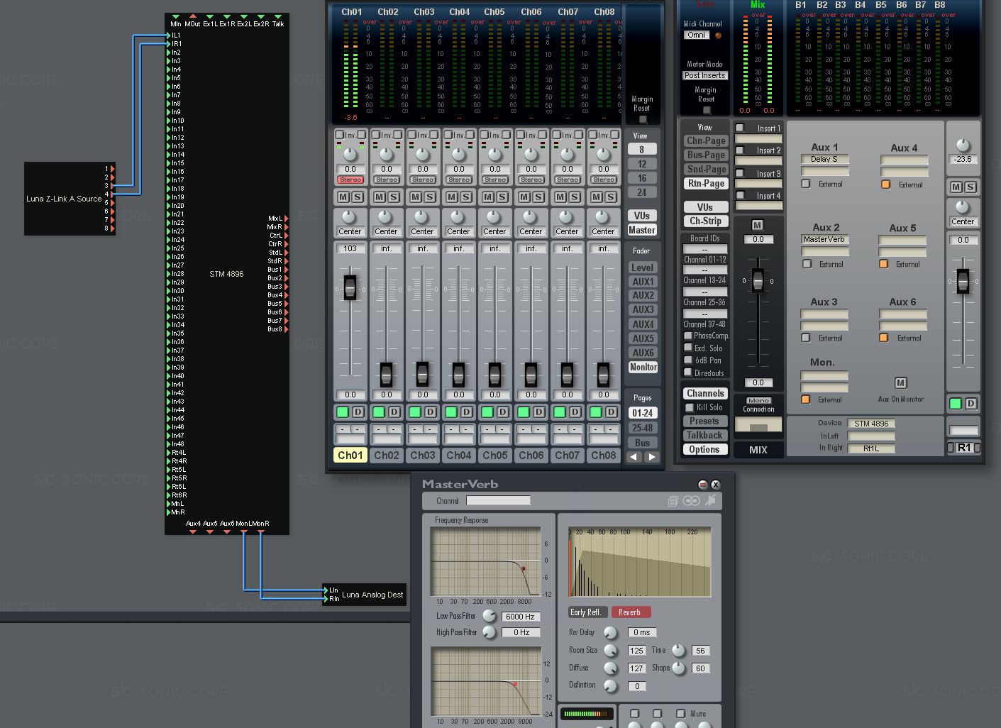

Hello,
I don't have a technical problem, rather an logic problem regarding STM 2448 monitor output and mode. In simple terms, I want to utilize Scope send effects in its internal AUX space. But it seems to be impossible. Maybe the monitor part should just work in that way? I have read its manual but I'm only getting effects to work in mix and control room mode outputs. I'm actually getting input signal into AUX effects, but nothing in return.
maybe I'm missing the point here? Check the attached screen dump. I'm not trying to do anything complicated. Any suggestions?
Cheers!
Routing screen dump.

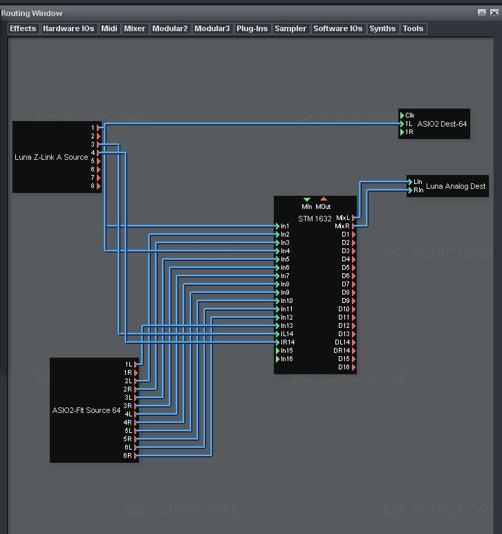

Actually, there is no point to complicate it, so I used 'Y' connection magic which helped me to total dismiss the need of monitor part. Simple and easy :) Check attached image :)
