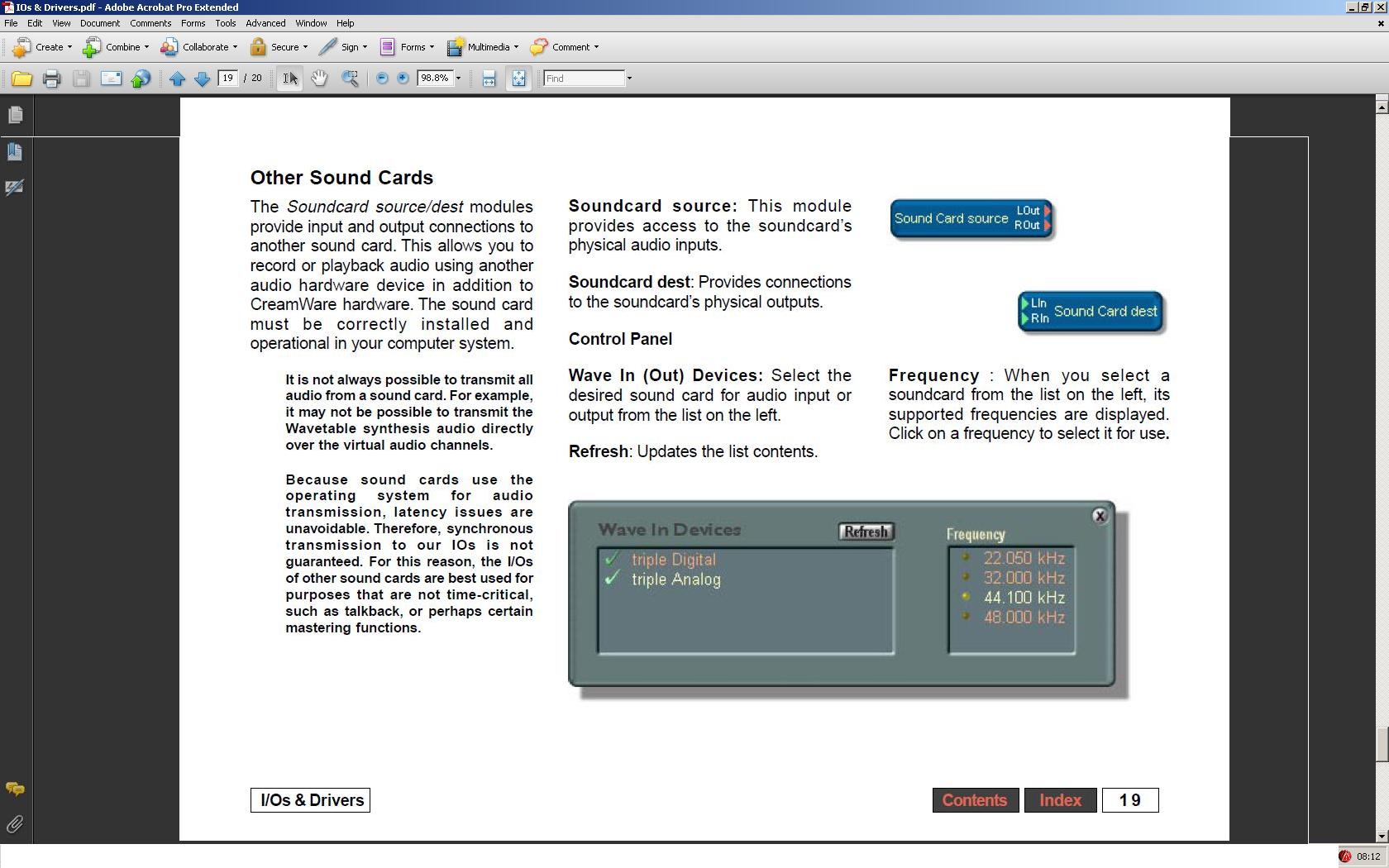

It certainly is possible to run two different cards within the same pc. Years ago when I got my first pulsar I was running it alongside an m-audio 1010 which at the time handled all physical connections from external synths etc and could be passed to scope via digital i/o and the scope module known as The Soundcard Source Module.
As your sequencer will only be able to utiluise one card at a time (ASIO) you would choose scope as your card in the DAW and then route audio with these modules and midi would be handled through scope as well.You will have latency but it's an acceptable workaround until you can find another way of getting your i/o to scope which for me was an behringer ultra gain which gives phantom power and 8 channels with adat i/lo which expanded nicely when I was able to afford the Scope A16 ultra. There is always a way with scope.
The other workarounds would be to start your recording sessions with your old soundcard in your DAW and when everything is to your liking switch over to the pulsar or output from scopes other software i/o (wav drivers) again latency would be an issue.
All FX sounds great to me, bear in mind tempo sync isn't automatic but isn't difficult to acheive either. Everything but the timestreching could be easily handled in scope either with stock fx or modular patching. Timestreching is acheivable though the STS samplers however the processing is non-realtime unlike the rest of scope.
- I.O info.JPG (197.07 KiB) Viewed 4351 times
