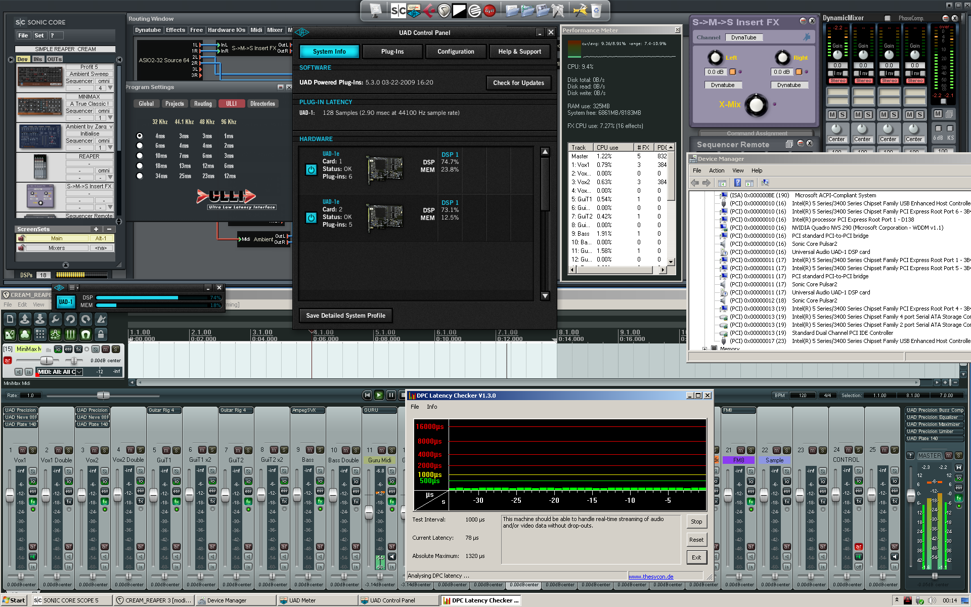

Hi All,
I found a motherboard that will work with '3xPII' and '2xUAD1 PCIe'. Here's the link:
http://www.msi.com/product/mb/P55-CD53.html
Running 'Reaper 3.74' and 'Scope v5.1 x64' on '64 bit Windows 7 Ultimate'. Seeing all 8GB of RAM. Also works perfectly with Cubase 5.1 (recently sold
No crashes or spikes:
Only problems are software related:
1) Can't load modules into Modular
2) VDAT doesn't work
3) STS5000 not stable
4) Weird error about not the correct preset file for some reverbs
Hopefully I'll be able to sort these out?
Have a look at the screenshot for more info
Laters,
CGF

Re: 3xPCI and 2xPCIe togther
i'm glad you've gotten it going.
as to your errors, some or most will be cured by running Scope as administrator(right click on the desktop icon and choose "run as administrator"). the preset file might be fixed in a later version, you may be able to cure the message(which is meaningless) by creating a new preset bank for the reverb(masterverb, right?).
