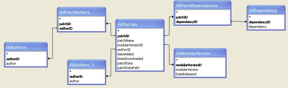

I'm finally going to do something I've been talking about for ages, which is to create a database of all the patches ever created for the Pulsar Modular. The idea is to have a database which is searchable by author, date, modular version, etc, and to try and make every patch ever created available for download (some of the patches hosted here and on the old Creamware site are not available at the moment).
I'm a fair way through the project at the moment (database exists, test page created), but I'm sure we have one or two php gurus here on the Z, and would appreciate a little help and advice every now and then.

Can't help with the php, but I can make a suggestions re the data model. I think a table of 3rd party add-ons would be usefull. You could then add a patch-to-3PL union table ( patch_id / 3PL_ID combinations ) which would establish all the prerequisite add-ons for a given patch. A user could then go in and search for all patches which do or dont require certain add-ons, depending on which ones they have (or dont have).

dante wrote:Can't help with the php, but I can make a suggestions re the data model. I think a table of 3rd party add-ons would be usefull. You could then add a patch-to-3PL union table ( patch_id / 3PL_ID combinations ) which would establish all the prerequisite add-ons for a given patch. A user could then go in and search for all patches which do or dont require certain add-ons, depending on which ones they have (or dont have).
Yes, I'd thought of doing something like this.
However, don't forget that you only need to worry about this if the add-on is licensed. All modules are saved with the patch, so if the 3rd party module doesn't require a license, it will open fine anyway.
Therefore, I think a fully blown lookup of 3rd party modules is overkill at this stage - I think I'll just have an indication in the main record if the patch requires any of the paid thrid party modules (which are Adern, Wolf, Zarg, SpaceF, I think).
Also, I'm not going to distinguish between different versions of Flexor - it'll be a 'uses Flexor' or not flag.
Ben

Thanks for all of that. I'm going to keep it really simple to start with - just one or two tables, and one page which allows you to query patches by:
name
author
date
Mod version
3rd party module use ( see last post)
so I think a simple mysql/php solution should be fine.
I'm happy with the database side of things (that's what I do in the real world), but if you can help with basic php, I'd be graateful.
thanks,
Ben

True, but a many-to-many on patch to 3Pmod could also yield benefits other than user avoiding add-ons they dont have, they could also use to it navigate patches for add-ons that they do have and that are thier favourite eg 'Show me all patches that use Flexor and Zarg'. Also, later on, if you were to introduce a rating system where you or users vote on a plug, you could then have 'Give me the top 10 patches that uses Flexor' etc. Handy also if you are deciding which add-on to buy next.
Probably overkill if theres only a few dozen patches...but if it grows to 100's...you might need a more powerful relational model.

Heres a suggested data model I had in mind. It has a bit of flexibility, as it stores multiple dependancies per patch, and each patch can have a main author and also co-authors if its a collaboration.
data model
data model
