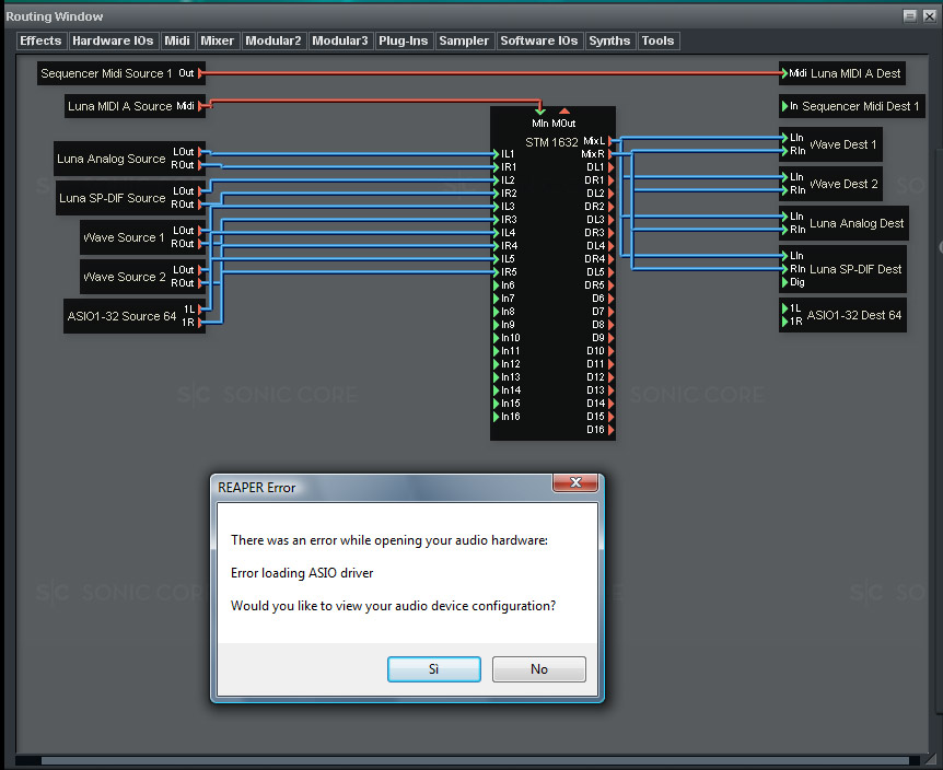

I'm checking out Reaper and Scope 5.1 PCI on Vista x64.
I get an error loading ASIO driver :-?

What is the error? And please post a picture p
Of your scope project :)

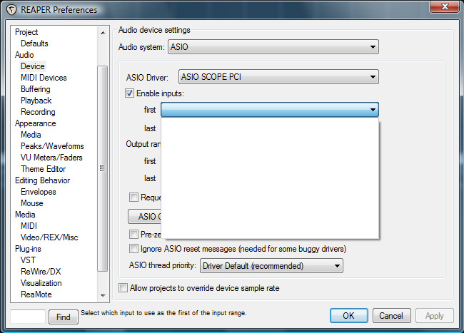

I've tried Reaper 32 in Vista 64 with Scope 5.1 x64...
...ASIO scope PCI isn't even showed in the audio device settings.

What happens if you enable that"Ignore asio reset messages" feature?And maybe after that try projekts can override device sample rate dialog.
Cochise
Posts: 1305
Re: Reaper 3.74/64 and ASIO Scope
Post by Cochise »
No way, till now; in/out channels are not seen... and it's a pity, since Scope and modules look loading smoother and faster in 64 bit environment.

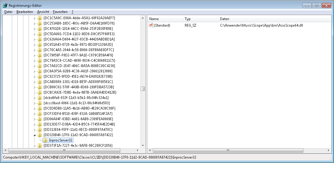

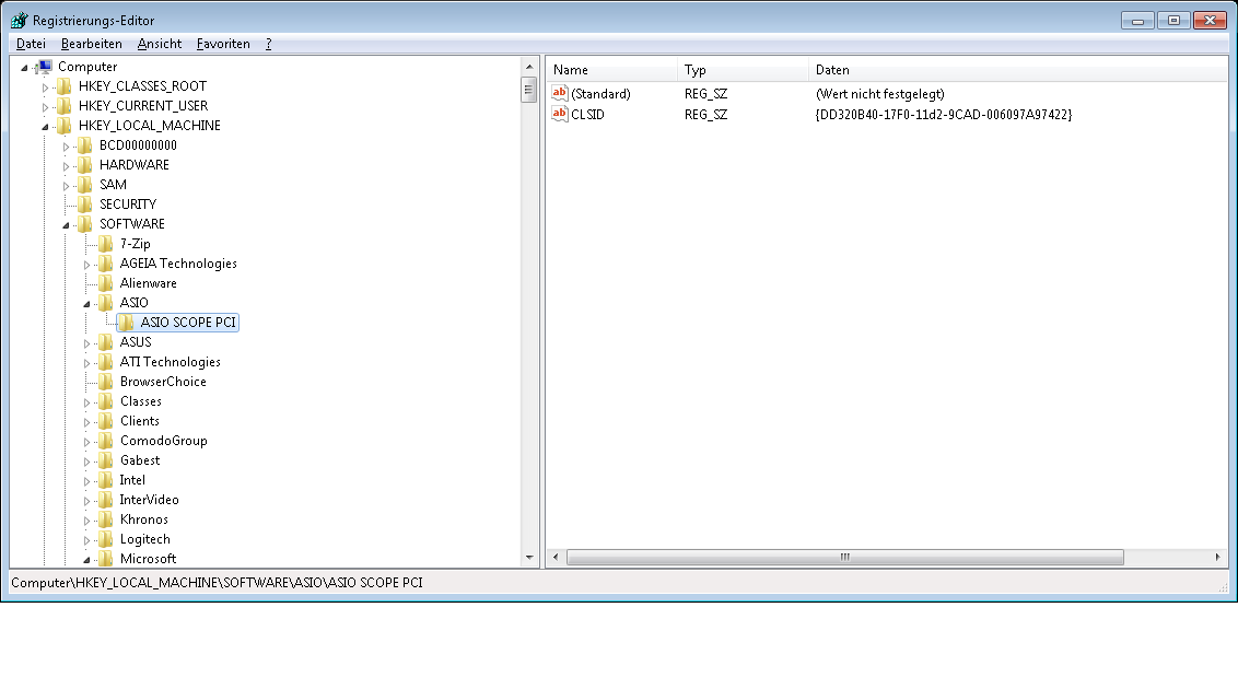

From any of you guys having similar configuration working, maybe it could be useful for me to know what's showed as content in the following registry keys:
HKEY_LOCAL_MACHINE\SOFTWARE\ASIO\ASIO SCOPE PCI
and
HKEY_CLASSES_ROOT\CLSID\{DD320B40-17F0-11D2-9CAD-006097A97422}
widy
Posts: 175
Location: Austria-Graz
Re: Reaper 3.74/64 and ASIO Scope (v5.1 - PCI)
Post by widy »
Cochise wrote:From any of you guys having similar configuration working, maybe it could be useful for me to know what's showed as content in the following registry keys:
and
lg widy

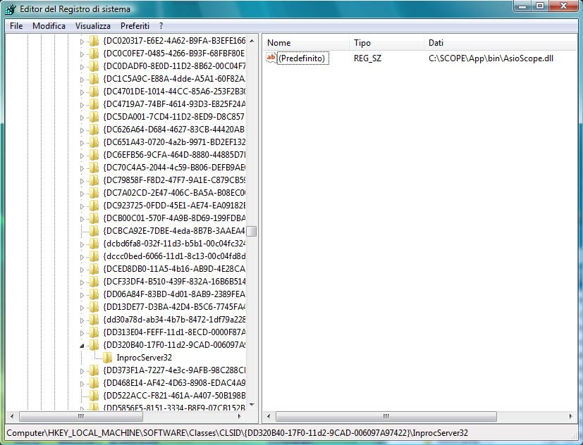

Mine is looking this way
Should I change it?
Cochise
Posts: 1305
Post by Cochise »
Changed.... WOW! looks like working now!
