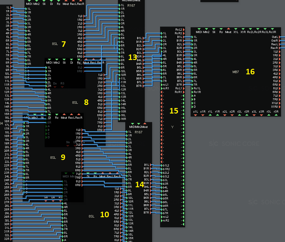

I seem to understand how to optimize use XITE for ASIO mixing. :)
I use modular mixer from SpaceF, Scope 5.1 RC2.
1 load Asio in outs, wave source, and other dest, set 64 channels.
2 load 4 SpaseF modmixer modules -8SL, 2 R167v modules, 16x16 merger, dynamicMixer for masterbus, Optimaster.
3 assign DSP like on picture, save and reopen project.
4 load plugins into inserts.
I got load:
x32 8BandParamEQ S
x32 HP\LP\BP (built-in ModMix Channels)
x32 KomPressor (wolf)
x12 Vinco S
x12 Limiter S
SC Ambience
SC RMX 160
MasterVerb Pro
Optimaster
Hell, I do not know what else to cram in there. :D

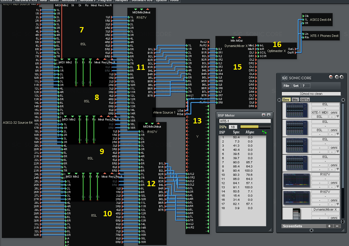

I did some experiments with phase correlation, and found better dsp assignment:
better dsp2.png (94.95 KiB) Viewed 10195 times

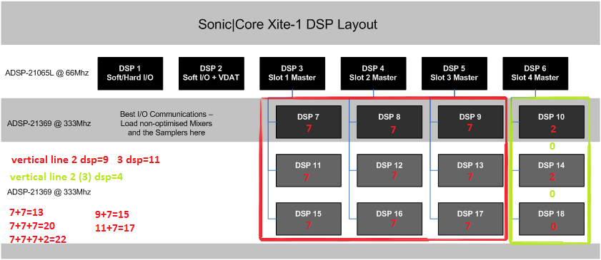

If someone is helpful, I tried to calculate the latency in samples for XITEs dsp
Please comment on .. :) where did I go wrong?
Xite -phase.png (43.59 KiB) Viewed 10002 times
XITE-1, Reaperx64...

I would appreciate if you could explain your picture - it's a bit unclear what the different numbers represents.
As stated earlier :
* Some processing methods introduce latency.
* When you include external hardware in your Scope projects - you will introduce latency because of the AD/DA stage (happens on all systems) - also if you connect digital units via AES/EBU
* Latency introduced by intercommunication
etc.
Here's a list of latencies regarding Waves TDM plugins : http://www.wavesupport.net/content.aspx?id=2213

I checked here, what will be a delay if I manually assign the DSP on modules.
For example, if you assign a module to 7 dsp (or any in red area) will be delayed seven samples.
sequential assignment adds latency. if "horizontal" 4 dsp - 22 smpl, if "verical 3 dsp - 11 samples
green area dsps - less then other dsp.
I'm not saying anything, just interested to find this out for yourself.
ps sorry for bad english
is there a latency in the XITE? - yes
Is that bad? No, because I know how to compensate for it.

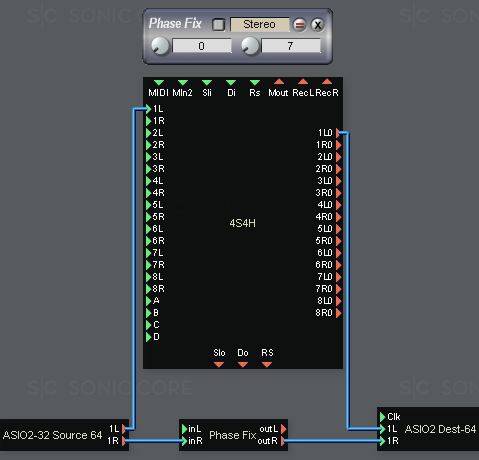

tjsound: One question relating to a point you made above. Did you use the phase compensation feature in 2448/4896 when doing your test (see page 18 of the manual)? As I understood it, that should fix the issue you identified.

if I understand well, the latency of dsp communication in Xite is likely to cause latency, not phase - at least not in the modular mixer if you connect things well together you don't necessarily get micro delays on different channels. at least that's what i see in the picture (the one above is 8 channels on another dsp than the latency checker... as there is no latency inside the mixer's channels(at least not to my scope-pci knowledge..)... if you are concerned about phase, you are concerned in latencies induced in parallel processes, not cascaded modules that act as latency nullifiers (if latency of all parallel processes is equal, all channels are aligned (variation of parallel latencies = 0). For phase, you can compensate automatically if you force devices to load on certain dsp in a certain way, but for a cost in dsp ressources. You cannot compensate automatically for user-induced-latencies (some effects on various channels). There are also tons of tools and methods for this for scope and sequencers (cut/add samples, track delays etc).... ps, if you want to compare, 22 samples is just a bit more than what it takes to trigger an envelope (15/20 samples, depends on the trigger).

2 w_ellis : this test is only for XITE - on STM 2448-X (xite version) do not even have buttons "phase fix", and I have not tested the latency value between the two channels (1-10 for example) a single device, I was surprised that this is possible..
This is impossible in Modular mixer from SpaseF, so I'm going to use it. And for many other reasons. :)
