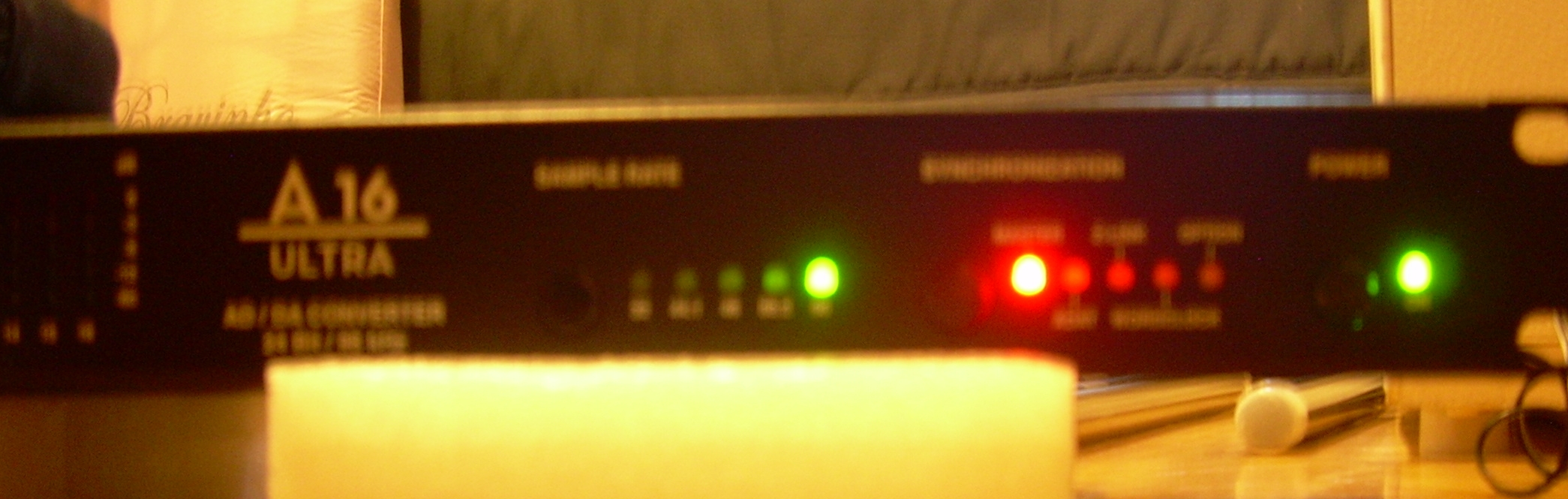

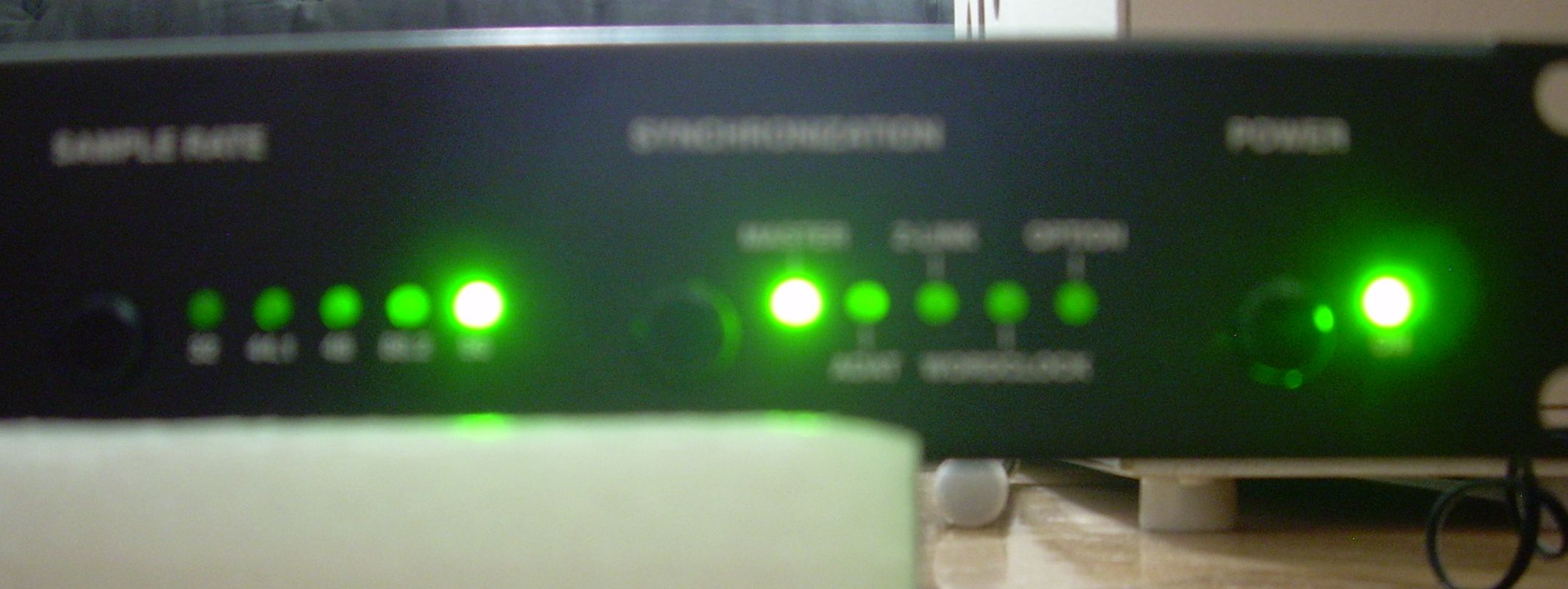

Hello. After 15 minutes working my SC A16 Ultra (black face version) get out of sync (sync led go to red) only in 96 kHz and 48 kHz. The same happens if set A16U in wordclock and setup my RME fireface 800 as a master. If I turn off A16U for a 10/20 minutes and turn on again, green led appears again, but after 15 minutes red led backs.
SYNC: Master (green led before 15 minutes, them goes red )
SAMPLE RATE: 96 or 48
SYNC: Wordclock (green led before 15 minutes, them goes red )
There's any solution, or I should contact SC support?

After 15 minutes
After 15 minutes
Before 15 minutes
Before 15 minutes
