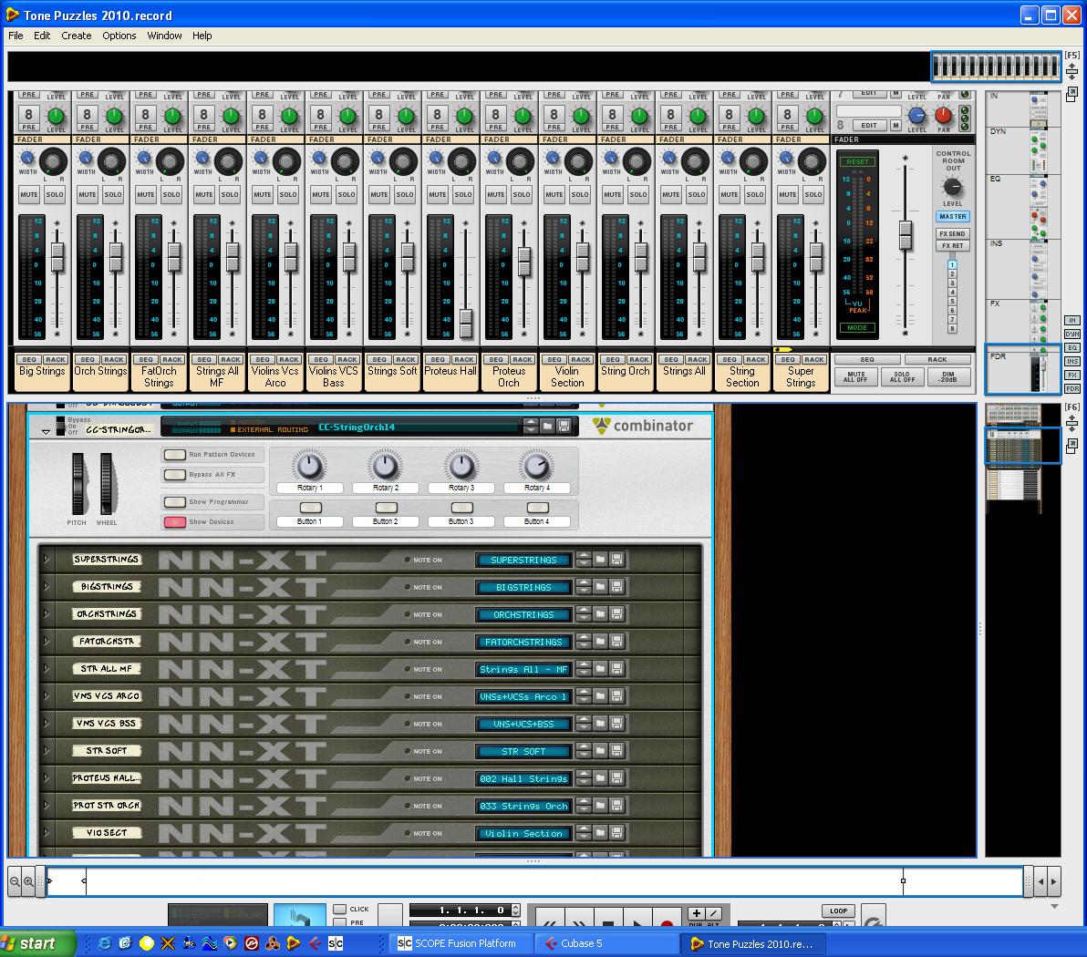

I'm covering this in ScopeRise Nov - linking up Reason / Record / Cubase / Scope, I'm working on a showcase track with instruments from all 4 plus outboard synth.garyb wrote:what is so great and only available in Reason?
I dont think it's a case of Reason having things that aren't available elsewhere, but it is a case of Reason/Record having the ability to do certain things quickly and cheaper, workflow and cost-effectiveness if you like. With the Record SLL I can build up a massive orchestral sound (submixed down to stereo for use in a larger Cubase/Scope mix) comparable for certain purposes (in a mix) to one of the larger orchestral packages but much lighter on CPU and the pocket (to this Ive added Kontakt LASS strings recommended by Jimmy - again light on the pocket ankyu).
I agree no point if you've already invested in EWQL and have a 64 bit system capable of running the biggest EWQL platinum 24 bit libraries - but not all user's are that cashed up

No antagonism taken (or intended) - was just an excuse for me to post a big pic reallygaryb wrote:ok, Bud. i don't mean to be antagonistic.
