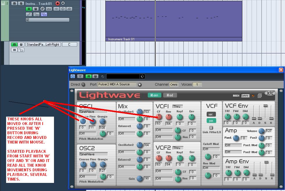

Well it seems to be working on mine, some of the Scope devices dont load - LightWave 5 gives an error, so this is just normal LightWave.
LightWave XTC Automated
Ive got one automation track and its recorded the movement of 3 knobs on the lightwave.
