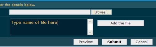

When you press the 'Post Reply' button, and the window comes up where you type, below it is a browse button.
Click the Browse Button, select your file, type in the name of the file or comment in the 'file comment' box, then press 'add the file' button.

Then after it upload, put your cursor back in your message test box, and press 'place inline'

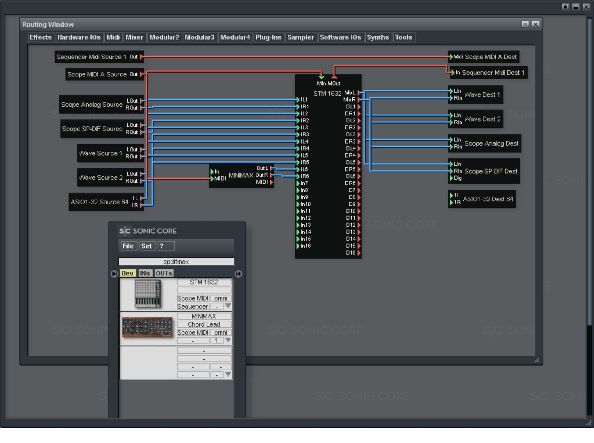

Here is a .jpg. It is a simple startup.

Ok thanks cybermooks. Its a bit small and blurred, could you possibly make it a bit bigger so I can read the writing on the devices ? Up to 200K should be OK.

This is 184k
Posts: 5055
Re: Scope works fine but no other applications do
Ok that better. Well I can't see anything wrong in the project itself, I suppose it all depends on what you have connected to 'Sequencer Midi Source' ( Cubase midi track output ? ) and Scope MIDI A Source ( midi cable from Mac ? ).
Basically, this setup will send your sequencer track to an external synth (connected to Scope MIDI A Dest ) and your Scope MIDI A Source to the MINIMAX and STM 1632 - which is OK if this is what you intend.
Otherwise, if you want to control the MINIMAX from a sequencer on the same box as your scope card, you would have to connect Sequencer MIDI Source 1 to the MINIMAX.
Next thing I would try is connecting a MIDI MONITOR component to these 2 MIDI sources ( you can leave the current connections in place ) to see if there's any MIDI data coming in.

Yes Scope Midi Source A is a cable from the Mac and works fine. I haven't connected anything to Sequencer Midi Source (i.e. Cubase, Sonar) which may be the problem. I'm not sure how to do that. Again there is no problem playing any Scope instruments, it is just that I can't get midi input recognized in Sonar or any other standalone instrument even though it is set for Scope.
the Scope midi A source needs to connect to the sequencer dest. think of the sequencer dest as the mini input jacks of the sequencer. the Scope midi A source is the other end of the cable that comes into the computer from the controller....
the sequencer midi source is the midi output jack of the sequencer.
why do you have midi going through the mixer? is it being automated?

cybermooks wrote:I haven't connected anything to Sequencer Midi Source (i.e. Cubase, Sonar) which may be the problem. I'm not sure how to do that.
Well once you have Scope running with a Sequencer Midi Source, it should then appear as a MIDI output in Cubase or Sonar, if you look in the respective setup of the sequencer and make sure it is enabled to appear in the main program.
Cubase allows you to turn on or off the various MIDI I/Os so you only have to deal with the set of those you actually want to use.
So yeah, Sequencer Midi Source is no use to you if you're not using it as a MIDI I/O port in a sequencer on the same box.
yes, that's true. if the sequencer is in another box, the other box will need an interface and a cable connected to it, if through Scope, then from the card's midi output. in the routing window, the Scope midi A dest would be the thing to connect to to send midi to the other box. this behavior is exactly the same as any hardware...

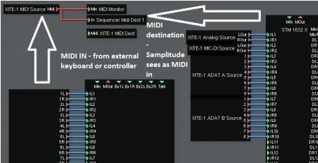

Well if you connect a midi keyboard to a scope midi input, then in scope project you can connect Scope MIDI Source to Sequencer MIDI Dest then run cubase, the midi should transmit to a cubase track where you select scope midi as it's input. In your diagram these 2 connectors have the STM in the middle - I dont think STM will re-transmit out what its receiving in ( like a 'thru' ) - coz if it did, my BCR setup would surely infinite loop :lol:
You can see how GregH did this for samplitude - select 'Scope Project Overview' menu at
http://www.hitfoundry.com/issue_02/samptude.htm
example
