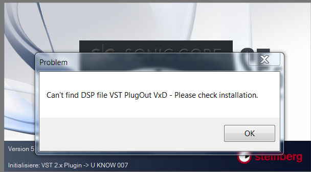

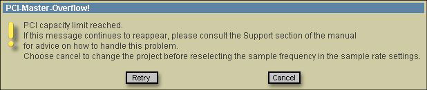

so, xite with xtc mode has still problems:
- pci-overflow.jpg (19.07 KiB) Viewed 10492 times
- vst-plugout-dsp-error.jpg (31.37 KiB) Viewed 10492 times
