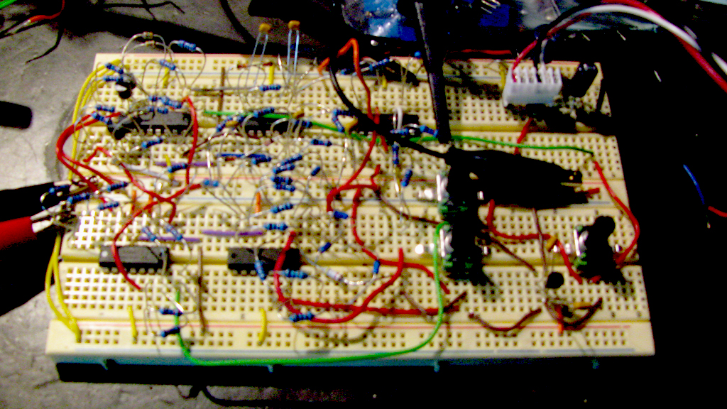

I am building up a modular synthesizer with various DIY modules from oakley sound etc.
One thing i really like on scope is the "rotor" so just for a laugh i tried to make one in an electronic simulation program (Texas instruments Tina Ti) anyways it appeared to work, so i have built it up on a protoboard.

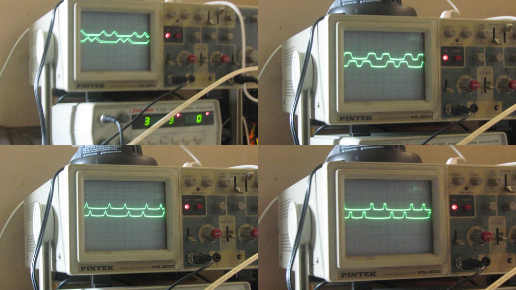

I am still waiting for the VCA chips, but the controller section is working perfectly and almost exactly like the simulation (i had to change some minor things for stability)
This is just 2 out of 4 of the controller cells, because my oscilloscope only has 2 channels and the protoboard is too small :)
all using common and cheap quad TL084 opamps and a few common jfets. (VCA chips are slightly harder to find but still made THAT2180.) and 90% the resistors are 10k :)
rotomatic prototype.jpg (733.88 KiB) Viewed 1018 times
rotomatic scope.jpg (510.3 KiB) Viewed 1018 times

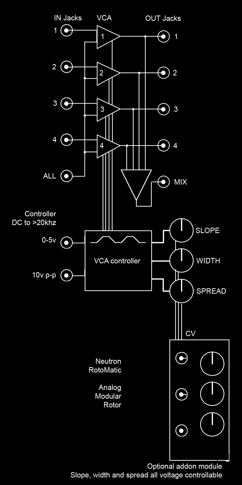

diagram1 copy.jpg (329.4 KiB) Viewed 1018 times
Differences between this and the scope version of "scope dsp module rotor"
Scope version has a built in oscillator, while this uses an external control voltage or oscillator.
Scope version only works in one direction, this can be 1 in to 4 out, 4 in to one out, or 4 in to 4 out
This version has adjustable "width" of the on time as well as adjustable slope. the on times can overlap or be separated by silence.
