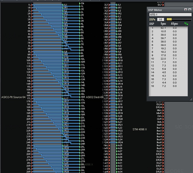

Re: PCi user waiting for comment
So far it seems like the limitations of using several hundred connections and a shitload of SpaceF Modular Mixers being connected has been addressed.
I just started messing around.
Several DSP files have new sizes which is a sign of lots of work.
I like surprises, this just might be a sweet little start.
Below I lost count using 3 x SpaceF Modular STEM 247's and Sharcs 64 stereo channel mixer.
Several hundred connections though which I will never use actually.
But it reminds me of the little game called Spirograph I played with as a kid........
Hold down the N QWERTY key and let 'em rip. Very fast connections too.
But I just installed a new OS, so maybe that has something to do with it too.
Anyways, thanks to whoever found this.
I will report back with other tests eventually, but I am looking at Modular IV to see if some fixes have been added.
I was limited with connections before, but after several hundred connections being made I grew weary and just took a screenshot.

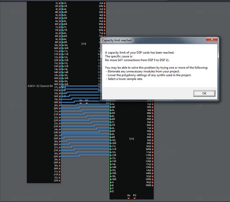

for asio nothing changed...
- no more sat.jpg (102.13 KiB) Viewed 7918 times
XITE-1, Reaperx64...
Don't take this the wrong way but I have a few questions.
When you install new DSP files over the old ones, are you taking the time to use Select All / Copy / Paste of the old files, than paste over the new files and say No about 3 hundred times..?
Also does this problem occur when using the STM4896..?
I have noticed new behavior when using the STM4896. I can max out all connections and ASIO I/O's, but when I load a second STM4896 it doesn't show me a window or any sign of trouble. It just won't allow me to make further connections..........??

Below I have no windows or warnings and I am strangely locked out from making further connections..............zero.
These kind of inconsistencies make me leary of using it live.
1 no.
I do a clean install.
2 with STM 4896 no problem.
3 about "impossible" connect - I've seen this error before, connect IS enable, but only "manual select" in scope sidebar, usually after a reboot everything works well, but I could be wrong, can not remember exactly..
4 2STM 4896 seems to work...
For this, first try assigning the S16's to another DSP like 14, and then try hooking up the rest of the ASIO I/O's.tjsound wrote:for asio nothing changed...
Afterwards manually clear the DSP assignments on the S16.
Again, Ralf has mentioned that the 4896's are already optimized for DSP usage. It's the 3rd party devices such as the spacef modulars that are not automatically optimizing for DSP distribution (yet).
Why not use shift-n ?XITE-1/4LIVE wrote:Hold down the N QWERTY key and let 'em rip. Very fast connections too.
