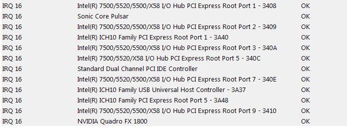

Re: PC noise in scope/pulsar card
OK, i found that my video card and scope card share the same IRQ 16.
can i change this? and what would i change it to?
yes, firewire and usb are also prey to grounding issues, but i don't think that that is your problem.
ahhh, the old video shared irq. it doesn't always make trouble, but when it does the trouble looks like yours...
the best thing would be to move to another slot. when you do that, tell me what the card is sharing with, and i'll tell you how to eliminate the shared irq all together(assuming that you get another shgared irq).
hey gary,
i moved the video card to another slot and the problem is still there
they still share the same IRQ 16.
i cant move the scope card cause i have a X58UD7 MB and it only has 1 PCI slot.
any other suggestions mate?
thanks
thanks
Google how to change IRQ for your particular OS version. Most likely it will involve disabling ACPI, which in later OS's is responsible for IRQ assignment. With ACPI enabled, the OS makes the decisions on IRQ assignment and you can't change it. With it disabled, you can, although its also possible to lose some functionality of your PC (like being able to shut it off from windows start button or from other software...it will start shutting down and at the end you get a message that its now safe to shut off your pc instead of it doing it for you).
bad news.
i would consider a different motherboard. the cost will likely be less than a new sound card...
