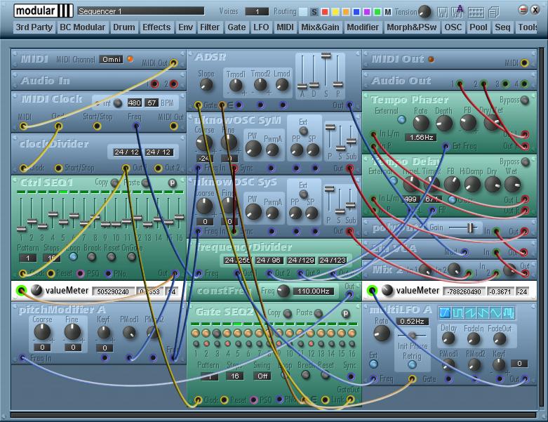

I enclose a screen grab of the patch - I have indeed got midi (with timecode) coming into Mod and if I hit play in Reaper stuff happens (excuse the patch but I was just goofin with the modules to see what happened).
Whats strange (to me) is that my BPM in Reaper is 120 - if you look at the midi clock in Mod its showing 480|57!

Can you try with some other application? FL Studio or Cubase or something else. Midi jitter is known to happen as roy pointed out but not that much like in your case.

good idea mpodrug. in any case, I'm sure that Scope & Modular cannot be blamed
but anyway, what's the advantage to use external sync? timing will be worse - even if it works. TempoDelay will produce crackles if tempo is changed, etc.
btw, when you connect a midi monitor module, or the MVC cwm, does it show "Timing clock" as shown below?

Midi monitor in Scope indicates timecode (F8) and in Modular as 'Timing Clock'
I've built the patch indicated on the CWM site and it works a treat - despite the strange numbers appearing in the midi clock the sequencer seems to lock onto Reaper fine.

Common practice on Scope would be to set each device's clock to 'internal', and set BPM of the device's MIDI clock the same as the native sequencer. Delay effects wouldn't notice, since they delay the audio as it comes in. For LFO's to be sync, FreqDivider like you used, from MIDI Clock module, sets the LFO to the same rate. For more fine control, you can retrigger the LFO using a dedicated note which is separated from the synth driving notes by a KeySplitter, for example use C6 or C1 or another out-of-range MIDI note, a note you wouldn't use to play the synth.
Using FleXoR's sequencing, synchronization can be achieved by a retriggered Ramp, which can be used to drive sequencers and shaped for LFO's: Ramp Divider creates harmonics of the original slower Ramp, or Saw2TriSin turns the Ramp into triangle or sine waveshapes.
My personal hotty is, instead of retriggering the Ramp, to record a very slow Ramp (8, 16, 32 or even 64 measures!) to a dedicated track and sending that 'master' Ramp to the different patches in the Scope Project. This makes sample-tight synchronization of all modulation effects and sequencers! Nothing new :>

Midi events have a length that isn't evenly divisible into every bpm. In the very old days, we used to set bpm according to the midi word length, what you're seeing is quantizing in action to midi frame boundaries.
Re: Syncing Modular to sequencer
the receiver does not know the tempo, he follows the clockpulse and tries constantly to readjust.
this is completely normal
