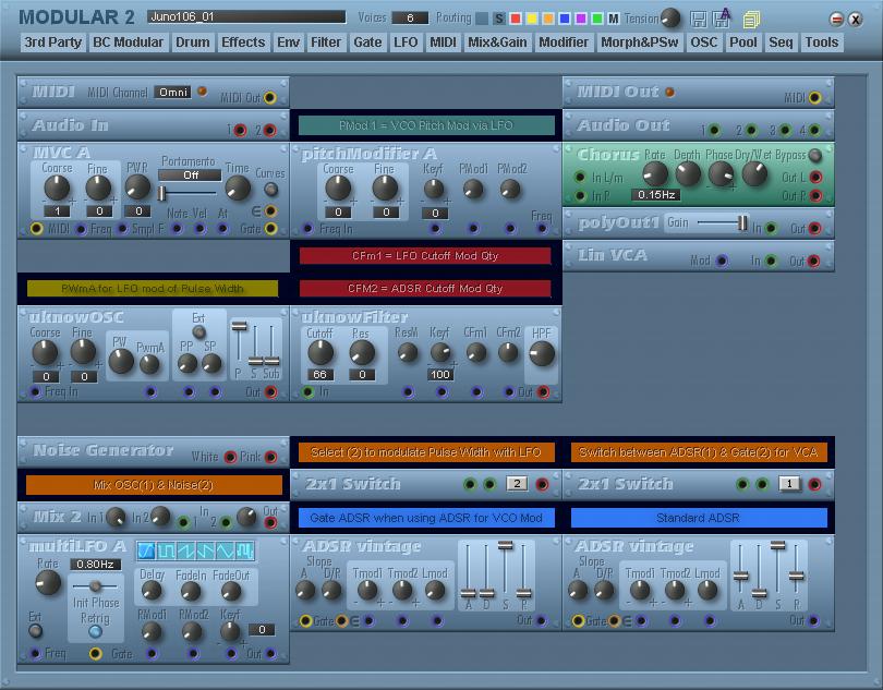

Hi all,
Been playing around in Mod 2 and creating presets for my Juno106 patch.
I've hit an issue with the presets I have created however - for some reason when I select a preset the visual display of the parameters in Mod 2 change to reflect the preset however the patch doesn't change sound i.e. if I set the OSC as SAW only and then pick a preset with Pulse only the sound is still all SAW?
I've not changed any of the modules or connections in the Mod patch since I saved the preset file.
Appreciate any advice.

OK -slightly duff info there.
I am creating a new preset file for my patch. I create a bank and then a couple of presets and store the file.
If I select one of the presets then some parameters change correctly however some dont! On my Juno patch for example the PW on the UKNOW OSC changes correctly but the CF of the filter doesn't and neither does my ADSR....go figure..
What am I doing wrong here as it must be me doing something stupid - it's driving me nuts however.

Thanks for the replies guys.
I've located the problem and it relates to assigning CC to parameters - if I remove my CC settings then the patch updates and sounds fine - if I add them again then modular misbehaves.
Anyone be able to confirm that this is not just me?
Assign some CC's to a vintage ADSR and save a couple of presets with different envelopes. Select them and let me know what happens - in my patch the ADSR settings change visually but the env sound is just the same...if I touch one of the env parameters the output changes to the correct env sound. If I remove the CC's then loading a preset works fine.
Si

confirmed, same here.
possible workaround: save your controler settings in the Midi controler preset list, and save another Midi controler preset with all CCs removed.
in this mode all presets work; if you want to use CCs again, just switch to your first CC preset again.

I've now recreated this odd behaviour and it's applies to most modules.
Roys solution does appear to work though :)
I'm finding that all presets saved after making midi cc assignments (even through the Midi Controller Settings window) don't recall correctly.
The presets made before making the midi cc assignment function as expected.
However, if I use the external midi controller to make the knob/button settings before the preset save then the preset is recalled as expected.
It seems, it is just when making mouse changes to the knob which has a midi cc assignment, then saving it, that causes an erronous preset recall behaviour.
I'll check on this further.
