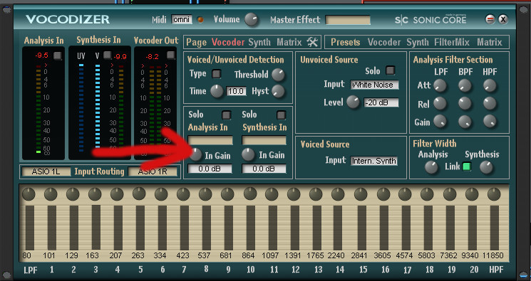

don't know if it has already been solved, just in case, my workaround is to double click(or just move) the "analysis in" pot, then save the project and it will work after reopening the project.
