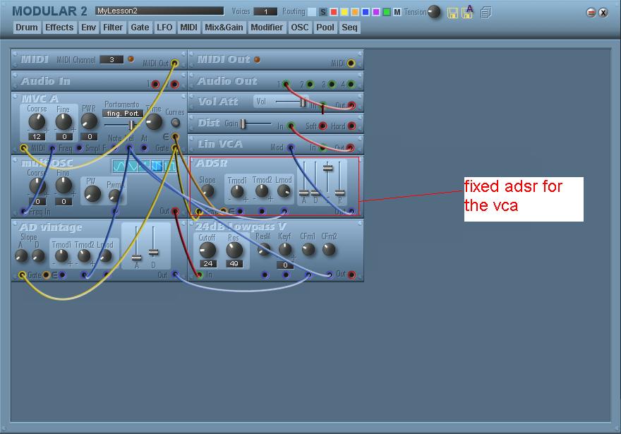

Thats the ADSR controlling the Lin VCA so :
So you want the attack fast / decay very high up so it dies out slowly and sustain/release at 0
Change the slope setting to exponential

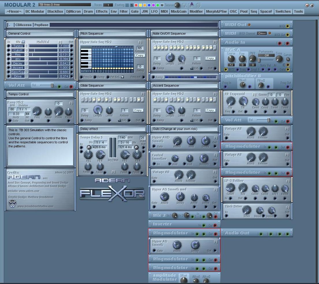

Right at0m I kind of stumbled across this today looking at one of the offcial flexor patches the tb free -0- free
In the guts of the circuit you can see the ring mods which in the case of the deacy is connected to the multi val and the amplitude modulator
crop expo env.JPG (202.58 KiB) Viewed 8284 times
The circuit that isistoy is the circuit we are working with so these additions wouldn't count in the homework anyway. It's just useful info I think
So you haven't been suckered at0m. Honest :D

You're right on the adsr.
Isistoy this one offers the decay mod
