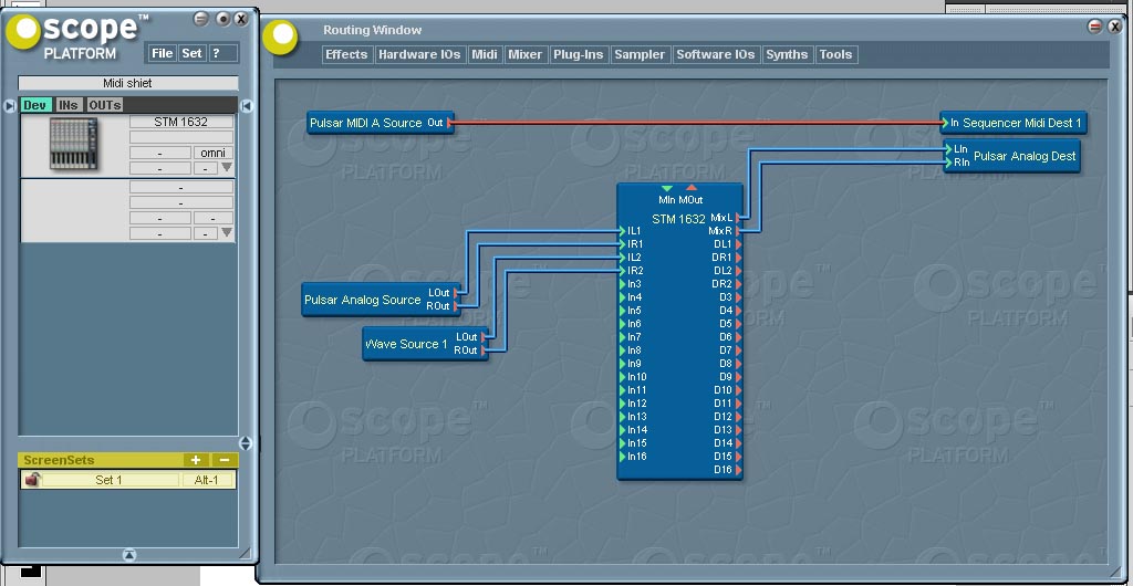

I attached a pic with the routing I did for my MIDI controlling which is lacking because of huge latency.
An internet buddy told me I need to route it to the ASIO dest in order to make it faster but I just couldn't figure out the right routing =\ (the ULLI is already set to 13ms)

you have to have asio modules in the routing window BEFORE Sonar is opened in order to have them available in Sonar. then, in Sonar's audio preferences, you must select asio as the driver type.
there are several asio types availabel in the software i/o menu, i'd use the asio2 24 or 32 bit source and the asio2 destination. you can right click on the asio source module, choose "surfaces", then "settings" and choose the number of ins and outs you want(ins go TO Sonar, outs come FROM Sonar). remember, you can connect, disconnect or reconnect the asio modules in the routing window any way or time you wish, but to change the TYPE of asio module or the number of channels, Sonar MUST be closed....
you can think of Scope as virtual reality. the routing window is the room that the hardware is in and Sonar is just a multitrack recorder in that room. the asio modules are the JACKS to connect wires to, just as though Sonar were a hardware harddisk recorder in your room, connected to a mixer and /or whatever else is in that room. anything that can be done in the realworld can be done in Scope, and the two worlds(Scope and the real one) connect with eachother throught he card's hardware i/o. use your imagination. :)
you may want to get a luna card or even a pulsar2 or 14 or 15 dsp card, the reason being that the later cards can do very low latencies to and from Sonar, like 4ms or less at 44.1k, while the older cards like your pulsar1 or the original 15dsp Scope cards can only do a minimum of 13ms latency at 44.1k. the lower latency makes playing vst instruments pretty much like playng hardware, while 13ms is less satisfactory, but is usable...

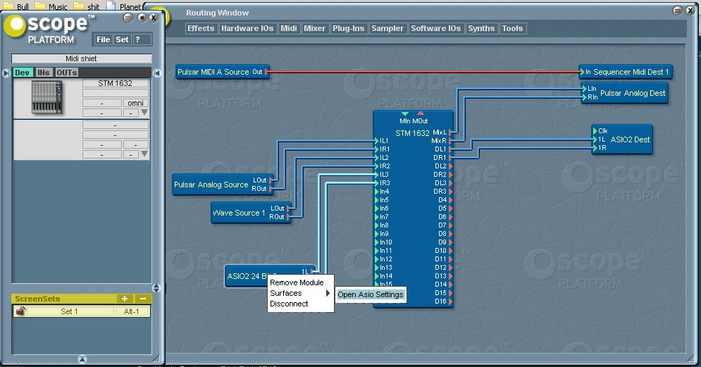

Check out my attached file.
I did as u said, I think, and still Sonar won't give me the ASIO driver and this time it wouldn't recognize the midi output either for some reason.
Also, when I press the "open ASIO settings" tab....nothing happens =\
sorry for my ignorance again :(
I heard about the possibility to buy those extensions u mentioned. Do u know where I might get one?
EDIT: check this out guys, I did the same thing in Fruity Loops and it works perfectly :D. the latency is almost imperceptible though I wouldn't mind getting one of those dsp cards.
thanks!
Re: VDrums>Midi>Sonar...routing :o
you need a sequencer midi source(from Sonar) in your routing window.

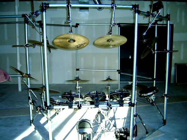

This is my new drum rig, I use a TD-20 with a TDW-20 expanded module...best sounds I have ever had...I even had DDRUM 4... :wink:

I can select the wood, the depth, tuning, effects, the drum head, the muffling, the positions of the mics, including on the floor, overhead, or even the next room!
I know...a pretty sick drum rig...those cymbals are 1982-1983 stamped Zildjians...the REAL thing, before they started screwing around with the alloys...A, Z, K...etc etc... :wink:

MY GOD that rig's insane! :o
I'm guessing it's gonna be improved bit by bit huh?
And what are those pads? those aren't Roland's...
u say the TD20 sounds better than the DDRUM4? interesting...
I was thinking about upgrading to a TD12 but now with these VST's working I think I'll keep my TD8 for a while :)

DDrum II. A real rim & drum head..10" toms and the floor tom...ha ha is a 12" and so are the (2) snares.
Phase II will be a stand up rig to the left of the photo w/ a Roland SPDS (2) Nimrods (2) Dingbats and (2) Hart Hammers & (6) more DDrum II pads, all commected to a Roland PM16. Behind the kit will be another sit down kit with 10 Simmons pads, and a variety of FX cymbals...trash, pangs, chinas...etc etc connected to another Roland PM16. The PM16s will be connected via MIDI to my XITE-1 loaded with STS2000 samplers, filled with a pretty huge library I've accumulated over the past 15 years... :wink:
I have all the pads, triggers and the PM16s, now I just need all the mounting hardware...the SPDS is under the towel... :lol: :wink: I have issues... :lol:
Stay tuned....later this year, when it is done, I will announce the completion and openning of my new post production/redcording/jamming facility. Plenty of pics will follow.... :wink:
