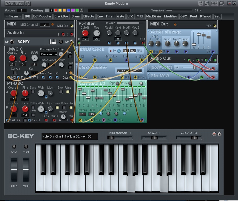

perhaps this hints at the way you should route ? you'd use the control sequencer here I think.

I just tried your patch to modulate filter cutoff and it still didn't work :(
Please try it yourself - use your patch but substitute the sequencer you used for ctl SEQ B1 to control the frequency cutoff of a filter with a single oscillator going through it.

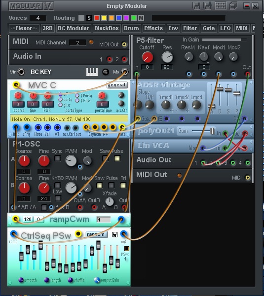

Hi Auricle, i had this up and running during the weekend, using scope 5 on a PCI card. I'm at work at the moment but i'll post a working example in a couple of hours.
Re: Sequencer as modulator
This works here, haven't got an xite so i cant try it there.
...But i much prefer this solution

I tried your first setup and that doesn't work for me either :( I've no idea what it could be - I set it up exactly as you have it (minus the keyboard - I use a physical keyboard but it works okay).

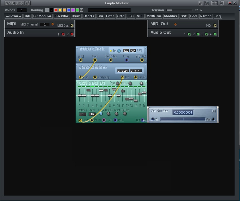

Ok, i just read further up you have flexor.
do a simple setup as shown below. see if you get any values out.
if its dead, and your vsti clock is blinking and the step indicator is moving, its buggy. if it shows values, the filters mod input is bugged...

I checked the output of the sequencer and got nothing.
Remembering a bug I had with Xor a while back, Assaf told me to re-install Scope 5 as sometimes files are overwritten that tends to break things. So, I just re-installed Scope and it works great!
Thanks to all for their suggestions and help and especially to NtN that gave me the inspiration to fix it. :D
