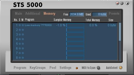

Got my new XITE-1. When trying to load any sample or library into any instance of the STS (3000, 4000 or 5000) it says
low memory error
Even when i try to create a new one ??????!!!!! :cry:
Running Windows XP SP3 @ ASUS P7P55D-E, 4 G RAM, 150 G WD Raptor, Intel Core i5 @ 2.6
In my old PC (also Win XP SP3 but other board and CPU) using the LUNA + Pulsar SRB (9 DSP) configuration, the STS 5000 worked perfectly.
Is there any trick? All forum posts regarding that problem didn't help.
There is definetely enough memory free. damn :(
THX

Find a screenshot of the STS 5000 message when trying to create a new sample.

I am getting the same thing on my XITE with all of the STS samplers.
reassigning DSP does not seem to help
I have 3.5 GB of RAM (I assume its RAM its reporting on) and in STS 5000 it reports 2Gb available with 0 used.
When I first tried the samplers they worked fine, but as soon as I went to use them in a project - LOW MEMORY and they have'nt worked since.
I might try the reboot trick mentioned here and see what that does.
