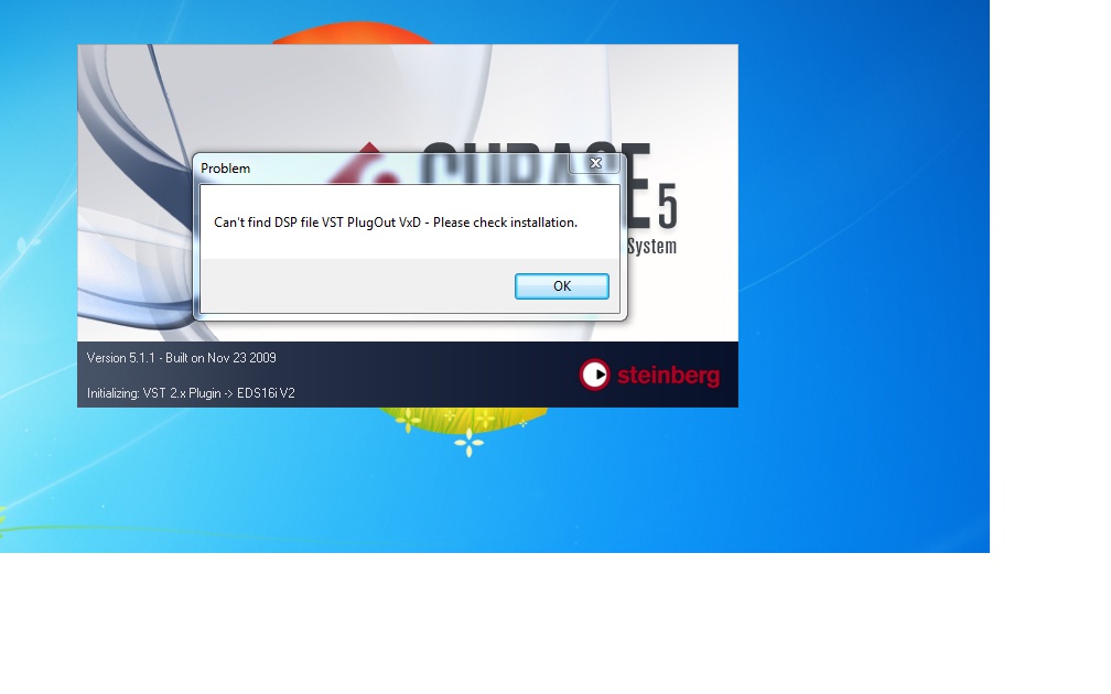

Hallo,
I did a fresh install windows 7 32bit, then installed SCOPE PCI v5.0.2617 (ENGLISH VERSION) with vst integration, reboot pc ,
exit the Scope PCI manager, start Cubase 5.1.1.120 .
The most Scope plugins loads ok, but all the Scope synth plugins and a few others give me Scope DSP File VST PlugOut Vxd Error !
See Picture.
Scope DSP File VST PlugOut Vxd Error.jpg (79.54 KiB) Viewed 1656 times
I have a dual boot with 1 harddrive win xp sp3 and a second harddrive win windows 7 ultimate.
Everything works fine under XP sp3 .
System asus p5wdh-deluxe , cpu q6600 ,4gb ram
I have tried everything , it's the first time i dont have a solution :-?
Someone with a solution ?

stardust wrote:did you install and load as administrator ?
VxD are drivers
Yes Everything is installed and running as admin, the strange thing is i cant find anything about this VxD , not in win7 and also not in Working Win XP !!, and i have full rights on both systems and also checked to view hidden files extension .......and most Scope VST Plugins works ! just like i said the Scope Synths and a few FX give me this error !
Also did 2 times full fresh install Win7 and scope5 !!!
P.L.U.R

Made a new XTCproject.pro , renamed the Scope PCI plugin folder and in Cubase 5 'Device setup-Asio Scope' a Reset !
Everything works now :P

Could you give a little more detail as I am experiencing the same problem. Do you create a new empty project. By plugins folder do you mean the folder under the vstplugins folder.
