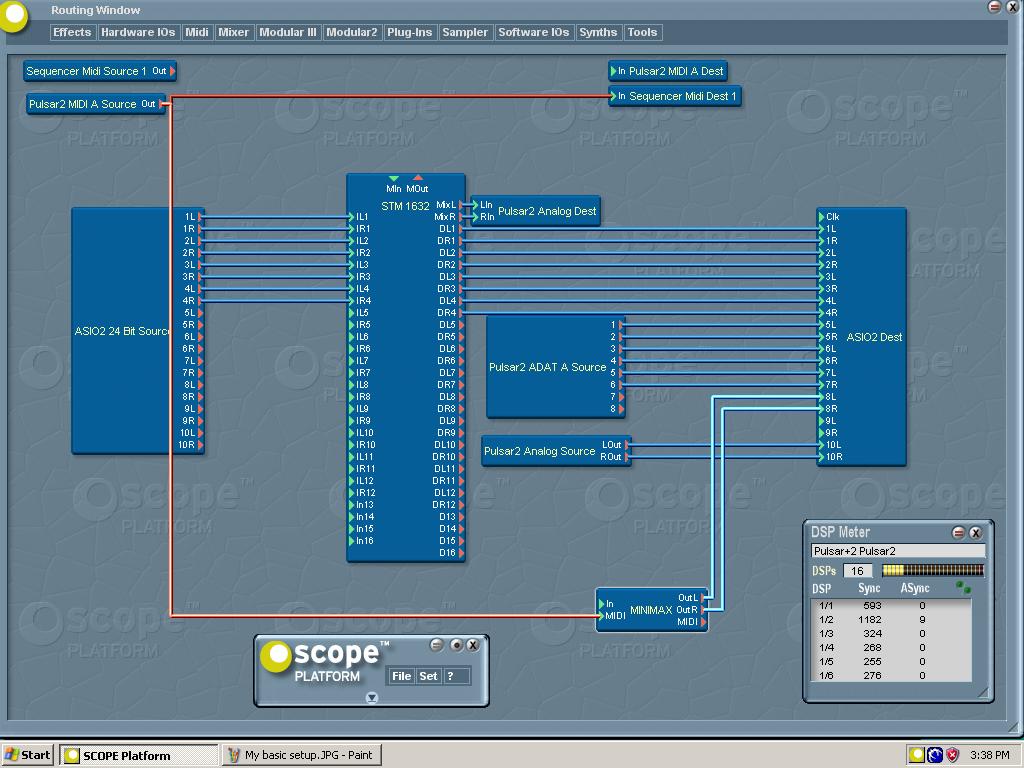

Here is a screenshot of my basic setup. Please don't laugh. For the time being it will do and allows me to record. I am sure I am not even scratching the surface.
I would appreciate some comments. As you can see my DSP load is very low, which makes me think I am nowhere near exploiting the full capabilities. Also makes me realise that I maybe shouldn't worry too much about not having enough PCI slots in future motherboards.
Can anyone see by this setup why I can't get MIDI from my sequencer to talk to my Scope synth?

- My basic setup.JPG (114.85 KiB) Viewed 3000 times

To trigger your Scope synth by the sequencer, you must link 'sequencer midi source' module to the synth... And set the right midi channel, output in the sequencer.
Re: Is Scope (PCI Card) Obsolete? Revisited.
disconect Pulsar2 midi source out and Minimax
(keep the connection from Pulsar 2 midi source to sequencer midi dest)
Connect Sequencer Midi Source 1 to Minimax
In your particular sequencer - set midi out to Scope/Pulsar

Thanks for the quick responses JoPo and Feg. It worked. Hoorah!!! Simple when you know how. Though I am sure I had already tried that combination. Maybe I forgot to configure the out signal properly.

Plus any comments on how I have currently configured my project? It would be interesting to know how experienced Scope users view my project. I don't mind negative comments or ridicule.
