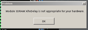

I just bought the Wolf 32 channels mixer... I allways have the optimization message that appears, and another one on the .jpg. I write to Wolf a message about this. He answered me that it has been already discusted here. Here is what he said :

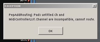

If I remember correctly, you need to assign the board to one ore more
dsps.
The "cannot route xyz" message is usually a sign, that not all parts
of the mixer were successfully loaded.
So another possibility could be to deactivate some of the upper mixer
channels (17-32).
Also try to use less Midi assignments (de-activate some .. or as
starting point all).
As far as I know pre 5.x devices are loaded on separate dsps on Xite.
On planetz I read, these are supposed to be the 1st 6 dsps listed in
the dsp usage meter. I'm not sure though ..
Does it mean that I must assign the mixer on one of the first 6 dsp ? And how may I assign more than 1 dsp to the mixer ?
Maybe someone uses the same mixer with his Xite ? Are midi assignments already done by default on Wolf mixers ?

- 32cha-mixer.jpg (23.31 KiB) Viewed 13113 times

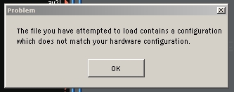

After assgning the 1st dsp to the 32 channel mixer, here is what I get (on .jpg)... And with the 6st, it's the same... I don't have anymore the optimization message but those ones, now. And there is no sound coming out of the mixer, no vu activity nowhere...
- 32cha-mixer2.jpg (19.7 KiB) Viewed 13098 times

And then this one after switching off a channel in the mixer !
There is also this strange thing : I saved my project with a lot of channel mixer switched off and each time I load it again ,the channels are on, even after saving the mixer as a .mdl and drag into the project.
Thanks for help if you have any idea !
- 32cha-mixer3.jpg (18.39 KiB) Viewed 13095 times

The mixer you send me seems to be the same as the Wolf default one... And I get the optimization message all the time after switching on the 9st channel... In fact, I may use the 32 channels mixer with 7 channels !
When I assign the mixer to one of the firsts 6 dsp, I get the message wich says that the hardware is not compatible and with the other dsp, it's the optimization message every time I do anything on the mixer but al least, I have some sound.
Wolf told me also that he doesn't have a Xite... So I don't know how he could make a xite version...
