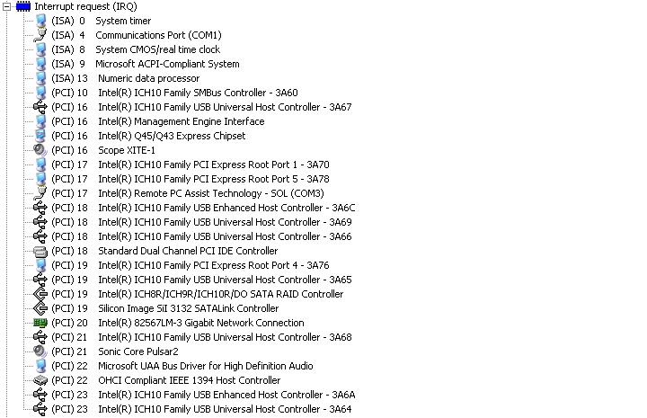

I have the XITE & a Pulasr II in the same machine.
Loaded 6 STS 2000 samplers & an SB404......
While running through presets, I got the PCI limit error.
I changed the DSP assignment of the SB404, and still get the message.
Approx. 30% DSP usage on my Intel DQ45CB mobo....with a BCF & BCR plugged in via USB (which I will switch to MIDI when the new 8x8 midi router arrives). Oh, all most forgot, I'm using on board dual head video....not the PCIe 16x for a video card...though I need more than 2 monitors at this point as well, to work more efficiently...with getting another video card...will that only make this situation worse?
any advise...here are the IRQ assignments as is
thanking you in advance...
Joel
Re: PCI limit reached
the usb controller number 3A67 must be disabled. another pcie port might be better...

DSP limit reached, after disabling the USB in IRQ selection in Device Manager...
SAT connections from DSP5 to DSPd?
any ideas?
Joel
