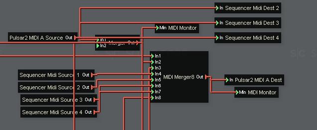

Hmm... you can create many midi driver ports... you can filter and route them to each other... that's pretty much 'multiclient'
Maybe that's the reason there's no 'real' multiclient. I don't know...

yeah, you can already connect any midi signal to as many programs as you wish by just putting more midi modules in the routing window. remember, any output can feed as many inputs as you like, even if the inputs can only be fed from one output.

ok, akaik you can't use your scope/Xite HWMidiOutput directly. You have to create a Midi seq dest/source and connect them with your HWMidiOut/In
in the routing window... If you want to use a second program, create a second pair of Midi Dest/Source and connect them via mergers in the routing window... Got it?

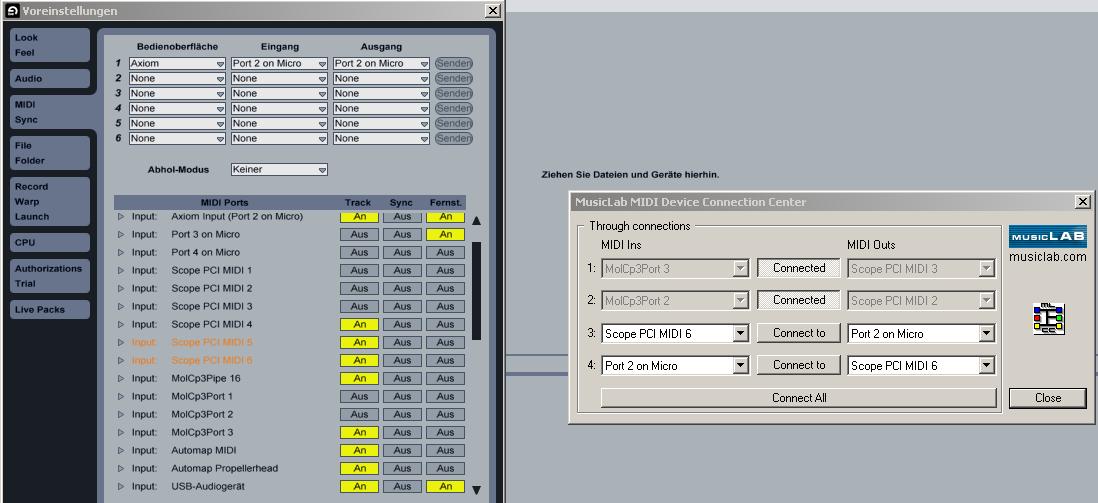

Sorry... I think my sequencer (ableton live) leaves unused midiports untouched so other applications
can use them (like I tried to show in my picture). May I ask what kind of seq you are using?
Maybe you can disable (in the seq) the midiports you want to use with your editor?
Maybe it helps to open first the editor (then midiport is blocked by editor) and then open seq?
Again, sorry...
Again, sorry...
