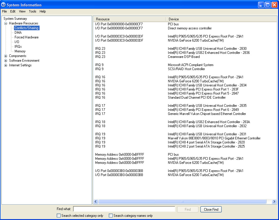

Ok.garyb wrote:go to start/programs/accessories/system tools/system information/hardware resources/conflicts-sharing and tell me what, if anything, is sharing an irq with the Scope card.
Here is a screenshot of the IRQ-ports. This is out of my knowledge, is it possible to fix the freeze-problem somehow whitout installing old drivers for scope-platform?

disable the two usb controllers on irq 23(numbers 2830 and 2836) in the device manager.

done!garyb wrote:disable the two usb controllers on irq 23(numbers 2830 and 2836) in the device manager.
Garyb, is the freezing a generally error when "devices" share irq-ports?

Scope can't share an irq.
if Scope, being a realtime app, can't access the system when it needs to because say, usb is hogging the line, then you get a freeze.
there's one other thing that will always cause a freeze. let's see if the problem is solved first, though....

Regards
Johan
