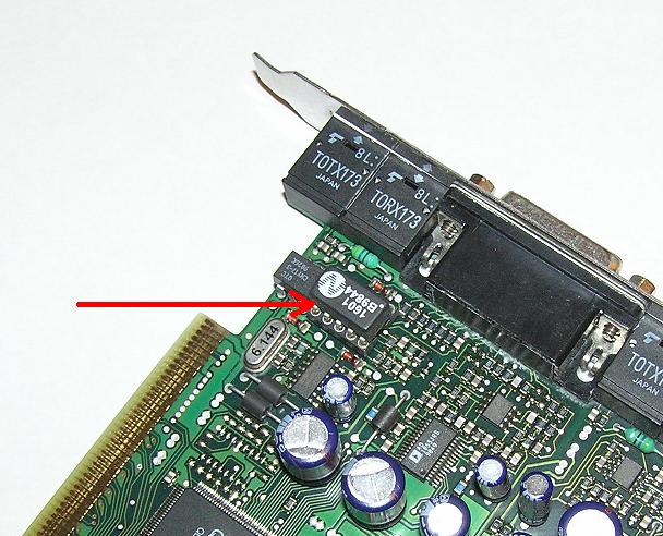

For Pulsar 1 cards its easy.There is a small chip in a socket near the connector to the cable whip which tells you that this is the "pro" version balanced with aes-ebu.For pulsar2/pro cards with seperate i/o plate...no idea,maybe there is 1 of those small chips on the plate aswell but i am not sure that it is in a socket and not soldered on.

I think this is the chip (marked 1601 B9844 on this one)

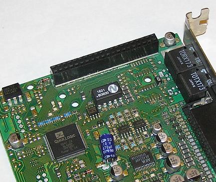

Plus/balanced i/o plate, 1601 B0600 (can anyone recognize the manufacturer's logo? I'm stumped atp)
Edit: plugged a classic whip into a Pulsar I balanced i/o card, with no ill effects. The outputs were noticeably hotter (+4dbu), inputs passed audio & digital i/o worked somewhat. Did not test MIDI.

wow a 10 pin IC, you don't see that every day.

Neutron wrote:wow a 10 pin IC, you don't see that every day.
Its 8 pins :wink: And the one on my pulsar 1 is only 4 pins if i remember correctly.

I can't look at the P1 anymore but the Plus plate's IC has 10 legs (just double checked). Flux, are two of the legs duplicated internally?
If you know what this chip is, give up the goods! :P

capacitor wrote:I can't look at the P1 anymore but the Plus plate's IC has 10 legs (just double checked). Flux, are two of the legs duplicated internally?
I was talking about the chip on the pic thats 8 pins on that pulsar 1.On my pulsar 1 i am pretty sure the chip is in the same spot but just has 4 pins each side.I would guess its a simple op amp to bring the signal to +4.

Probably a line driver or something like that
sometimes DSL drivers could be used for audio as well. then the extra legs might have been for current feedback or something.
but i couldnt even find that logo on my favorite IC logo looking up page.
http://www.advanced-tech.com/ic_logos/ic_logos.htm
and its kind of fat and beefy it might not even be an IC, maybe a miniature transformer or something.
and bringing the output up to +4 from a low signal would not be a very "pro" way to do it:) it has to be a bipolar balanced output, and depending on the DAC, it could already be bipolar on the DACs output.
anyway enough electronics boffinry for now :)
Re: how to find out balanced and unbalanced pulsars ?
It looks Chinese.
Also looks like it's from some old stockroom somewhere. :P
Yes, maybe an opamp, or driver chip. If corner pins are power/gnd, then my assumption is that it is a power driver, due to it's location down near the din connector.

siriusbliss wrote:It looks Chinese.
nah if it was Chinese it would say "national semiconductor" or "texas instruments" in badly silk screened printing and everyone's pulsar pros would be dead. :D

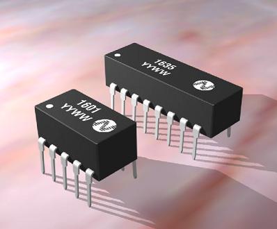

Update: found the datasheet for the 10 pin chip, by chance while seeking an 8 channel sample&hold circuit.
Note: middle pins unused
newport 1601.pdf
Newport (now C&D Tech) 1601 dual isolation transformer pack
