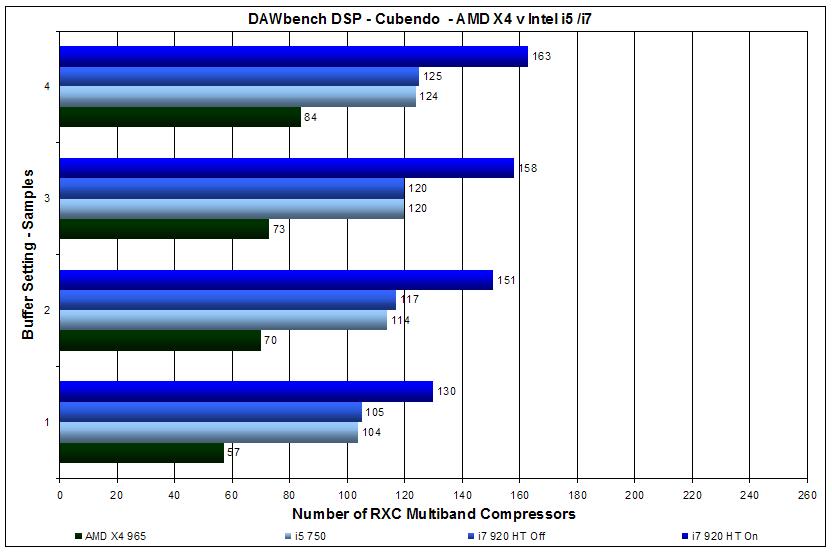

From the benchmark i seen the new i7 870 does not look like a bargain. It's retail price is $560 iirc and the older i7 920 outperforms it in that particular audio benchmark and its price is only $280. Below is the benchmark from ADK.
PS. The i5 750 seem to be a bargain tho.

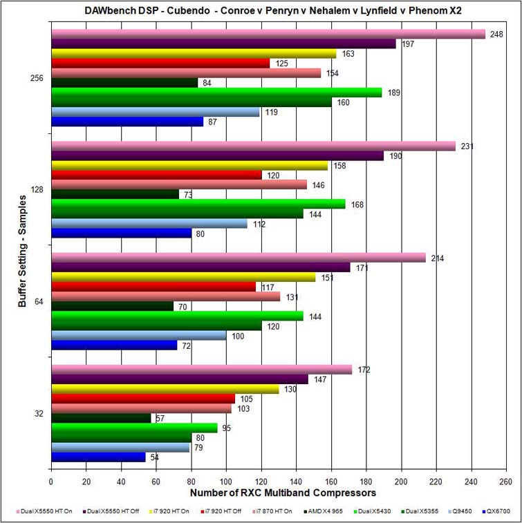

Interesting. But think about that graph for a second. Besides the fact that it makes no mention of system configuration or motherboard make/model/bios revision...and this is very early in the P55 game so that info is (imo) quite relevant. Also the i7 920 price ($280) are intended to be versus the i5 750 ($210) and i7 860 ($299) and once tuning issues settle out I think the performance will reflect that (and that's before even accounting for overall system cost).
In the more general computer benchmarks, the cache-coherent (on-core) multithreading & single threading tests (like povray/cinebench/blender) and the memory bandwidth tests show that the p55 platform is capable and performs as you'd expect based on pricing compared to the i7 nehelems. It would be really useful if ADK Pro Audio (who made the graph you posted) could do more testing and isolate exactly why you're seeing such reduced performance in that benchmark versus the other benchmarks out there right now.
The new cores bring higher frequencies at the same price points as the previous i7, and the cores haven't been cut down beyond removing the QPI connects. Trading the QPI & triple channel ddr3 for dual channel at lower latency & higher (validated) ddr3 speeds wouldn't show the disparity alone (shown in the graph above). And the cache sizes etc are unchanged though the new core has had a few specific long instruction eatures added and other core optimizations. Also it seems that DDR3-1600 is running fine on the p55/LGA-1156 boards from several makers (though beyond intel's spec) and OC'ers are getting DDR3 speeds up to 2000mhz (unnecessary for a DAW imo) so the DDR3 support has matured fast compared to X58's launch (which you would expect since mobo makers have been making X58 for a year now.)
So I would check back in 1-2 months and see if the benchmarks aren't changing. I would suspect those benchmarks are showing a BIOS tuning issue or something with the motherboard/chipset needing to be debugged. I remember that the mobo makers had a hell of a time with the x58 motherboards at launch too (though off the time of my head I can't recall if that was affecting audio benches as I just recall it affecting some RAID/SSD users.) That was actually close to 12 months ago now so you would certainly expect the x58/LGA 1366 to show its maturity.
Once you factor in the cost of an x58 motherboard & a usable amount of ram I believe you'll see prices on more par with building a quad Core2 'midrange' system, which is what I see most audio users targeting these days. When Intel brought out nehelem/i7 they made a break from the core/core2 line to address some shortcomings in the server/high end workstation markets. Lynnfield is again making a break from Nehelem to reduce motherboard complexity (quite a lot in fact) and reduce featureset for their middle of the market offerings.
So for users who don't need the top machine available at the time of purchase, I do still think that Lynnfield will scale quite nicely and be the modern alternative to Core2Quad for most. Just a question of finding the bugs (as always)

By the way that graph is almost the same when comparing this dual Xeon 5430here at work with i7 920at home for 3ds MAX rendering time. the dual xeon took 360 seconds to render a frame of my scene and the i7 took 280 (there were no bitmap textures, all procedural, so texture loading time does not count for anything)
Jimmy using a PCI matrox card seems a bit silly with scope cards, even iof it is just sipping on its own memory when it is displaying, how do you think it gets told what to display? through the PCI bus.
even a crappy $40 ATI on the PCIe ought to be better these days. the bus they are sharing is like the 8 lane highway compared to the dirt track donkey road that is PCI.

So the other errata we have introduced to this converation is that graph above, and honestly it's the first benchmark besides the ones I just mentioned where I've seen the 870 underperforming based on its pricepoint & configuration. The only real 'losses' that Lynnfield has shown against 920's are either memory bound tasks (expected with the reduction of 1 channel and mitigated quite a bit by the increase UNCORE speeds of the newer cpu's and the stabler performance with high speed ddr3,) or GPU scaling (especially for CUDA/OpenCL on nvidia). So I would really be curious to see why 870 takes such a hit in that particular benchmark. I did send an email to ADK Pro Audio to see if they had any explanation or more figured to go from, will report back if I hear anything.
Basically I only see 1 non-Xeon LGA-1366 (nehelem's socket) cpu listed on Intel's roadmap right now for Westmere, and it's the Gulftown cpu which should be branded i9. It looks great but it's currently listed as $1500, intending to be the 'Core2Extreme' pricepoint for that generation. Of course other Gulftowns will be Xeons, but where are the lower pricepoints for i9/i7? Intel seems to be saying the p55 introduction of the LGA-1156 socket is the new desktop socket from any info I've seen so far? So the questions I was posing are: will current p55 boards handle Clarkdale (upgrading to next gen i5) in terms of cpu support/voltage etc and will Clarkdale scale enough in performance to actually be an upgrade?
BIOS issues are much easier to answer in a few weeks time, the upgrade path is really up to Intel to flesh out. Either way, I guess we'll see...
Memory benchmarks of course still show i7 leading, but most of those aren't stressing the multiple PCIe lanes either. Stick a PCIe SAS card in RAID 10 (or RAID 0 with SSD) on there and try to do workstation graphics at the same time and you'll see why there's so much QPI bandwidth around. Lynnfield doesn't need that (and the Uncore speed bump along with the lower latency memory accesses without the hub attached to the QPI) seem to be doing fine with the platform in most less synthetic benchmarks (ie, besides the ones that only test a given subsystem.) Except that multiband compressor benchmark of course...

@Valis, Scott from ADK did state " FYI my 870 numbers may be a tad low due to the use of Beta Intel board they sent. now that we have retail release we will be retesting."
So i gather that the i7 870 numbers may improve a bit the next test.
The i5 750 will be added to the benchmark soon.

I stole this benchmark from KVR. It's said to be done by dawbench.com but TAFKAT has not posted it in any forums most of us visit yet so whether this benchmark is legit or not is'nt fully verified yet. The benchmark shows the i5 750 competing well with a i7 920 without HT enabled wich is the performance ADK said it is capable of.
- dbdsp-amd-v-intel-0809.jpg (59.63 KiB) Viewed 3954 times
Re: LGA-1156 (new Lynnfield i7/i5 on p55 chipset and beyond)
It's too bad they didnt' included i860/i870 since they're faster versions of that i5 with HT & TURBO core support enabled.
