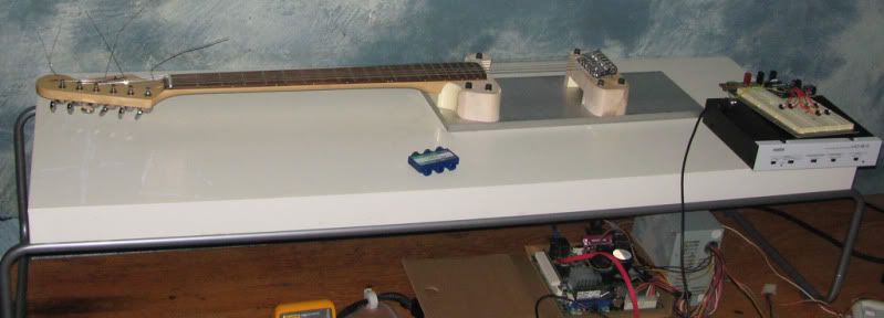

I have started a blog about this thing i have been collecting parts for and now started building in earnest.
It uses a pulsar 1 card in a slightly unusual way.
It may help explain the lack of devices lately from me :D
please note the fine color selection of the blog.

I'm concerned about overall PCI bus line lengths coming from the motherboard up through the bend connector into the P1.
Not sure if older Pulsars can handle longer line lengths or not. The PCI spec. is pretty specific about these types of things :P

well if worse comes to worse, ill just put it in a Shuttle cube. but an inch of PCI slottage shouldn't be much different from the next one along on the motherboard if it had one. thats a good quality PCI riser there, made in china by slaves who never even knew what they made.

I've always wondered about the potential for bodging some 'hardware' out of a mini motherboard and a Scope card - I guess as long as the routing doesn't change, you can come up with a stripped-down Windows install and all you have to do is turn the thing on... right? Are you writing an embedded XP for it or something?

sure you can, it might be even faster, This is not a fancy CPU or anything, and not a high end SSD. just make sure you get an Intel or Indilinx based one and not jmicron.
windows is pretty standard wih only security center, help and support, and wireless zero disabled.

Had much fun destroying a squier guitar today.
it is the testbed for the string drivers and pickup arrangement.

There is an update, and i have had the mini ITX running a self sequence modular drum machine patch trough a masterverb and PCI based delay for 3 hours now.
it looks like the Mini ITX might do the job!

siriusbliss wrote:I'm concerned about overall PCI bus line lengths coming from the motherboard up through the bend connector into the P1.
I have been running some PCI /PC RAM based plugins for a while (almost 4.5 hours) with the riser now and still no BSOD or crash. probably longer than i could run them for on my main scope rig (36DSP), i tend to shy away from PCI delays/reverbs and use external boxes for them.
