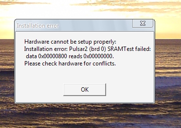

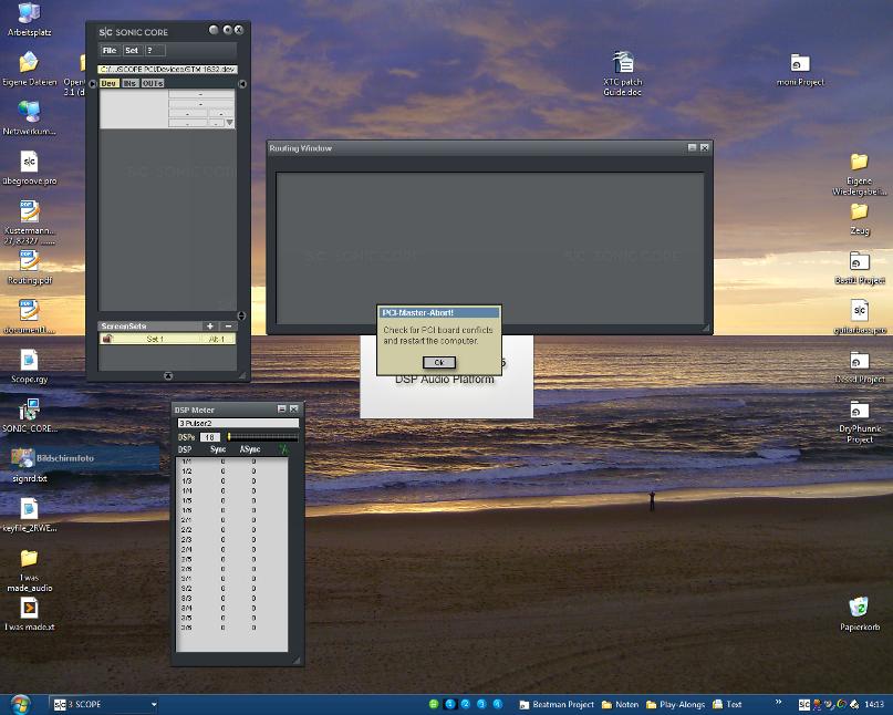

I have Scope5 installed for some weeks now, everything is running fine (except for the XTC-mode) and today out of the blue i get these messages.
I made sure that the cards were properly seated and all the STDM connections are ok.
My Specs:
3 Pulsar 2, Gigabyte DS3R, Win XP SP3, Intel Core Duo E 4500, Scope 5
Any ideas?
Sounds like a hardware problem, could it be my one of my Pulsars is simply broken?
Thanks in advance

....sorry. Solved.
I cleaned the contacts of my first card with the stabilant 22, now it works again...pfoooh! :)
