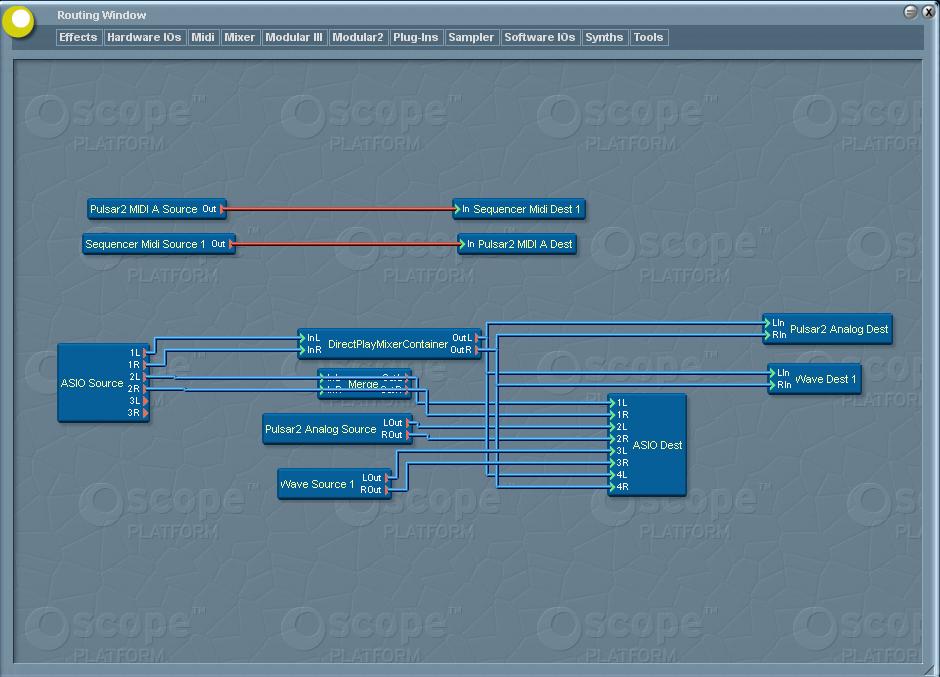

Hi all :) how are you.
I finished a project using XTC mode and it was great :).
The main thing that i don't like is that when i am working on cubase i have sound only for cubase if i open media player or anything else
I have no sound.
Is there a way around this ? so i will be able to use cubase + listen to music or wave files.
Thank you for your help
Tomer.

Open up your xtcproject.pto and add the "wave out" module..
Connect it to you main out.
save.
GO!

Hi and thank you for your help
I checked my project file (Attached jpg), and it seems that i have a "Wave dest" module.
What kind of change i need to make in order to here music while Cubase is open?.
Thank you Tomer.

Anyone? please i am really trying to solve this issue
I already tried many diffrent projects files with no luck :(?
Thank you Tomer.

Hello mate,
The 'Wave Dest' module doesn't have a lot to do with anything, in your case - you want the 'Wave Source' module routed to somewhere useful (the 'Pulsar Analog Dest' module, most likely).
Seeing as that module is already connected, however (and I presume you also want to hear your ASIO drivers!), just put a Micromixer in the project, with both ASIO and Wave modules connected to it, and connect the output of the mixer to your Analog Dest module.
Bob's your uncle.
Cheers!
