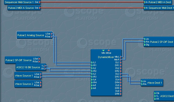

hi, im new here. i have two problem i hope somebody can tell me something about them...
1- if i add/plugged pulsar analog source any of the mixer i hear a lot of deepnoise (nothing plugged to hardware even its own classic20).if i dont add it there is no deepnoise but i want to connect my analog mixer to creamware project's audio-in.

background noise currently audible when analog source connected to any of the mixer on routing window.

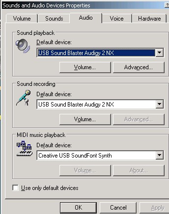

Pete wrote:I wonder if some setting in the Windows Sounds and Audio devices of Control Panel could be putting some noise into the analog source.
as seen the attached picture nothing related about scope.
scope would be for analog in and and asio (for vsti's) only. audio signal goes to sb audigy nx with toslink optical.
basically music for scope all other things for audigy nx but all sounds can hear from audigy because speakers and headphones connected to audigy.

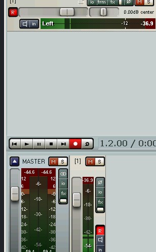

noise audio
vu
