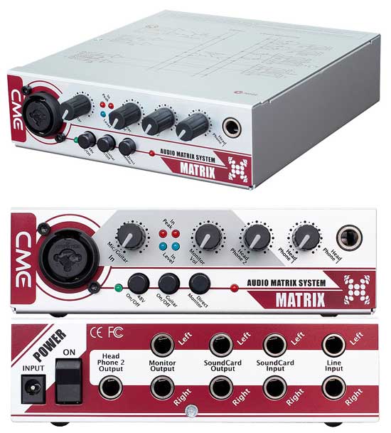

Re: Connecting a microphone to Scope - unbalanced input
- cmematrixx.jpg (49.04 KiB) Viewed 2706 times
It seems to be a good choice, especially as it doesn't appear to have balanced outs; as your Scope card don't have that. The labels "soundcard in/out" seems to imply unbalanced jacks. Of course, there's always the option to get one of those boxes that convert between balanced/unbalanced signals. No need to mess with altering the wiring that way.
Thanks for the replies
CME say the outputs are all balanced.
I was thinking of only connecting a cheap microphone to the pre amp - then into the line in of my Scope card (unbalanced)
I do have a Waldorf Blofeld which I got 2/3 weeks (my first hardware synth!) - just plugged it into the line in of scope (no idea if balanced or not - nothing in the manual)

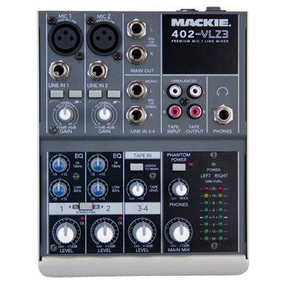

Perhaps a wee mixer is better?
like pic below
I'm not sure about passing my Scope output signals through this matrix thing then connecting it to my Yamaha monitors - will it degrade the signal??

The preamps on those are very good - much better than you'd think, given the cost (they're the same Onyx pres as on the larger Mackie VLZ3 desks).
There will be a very slight degradation to your monitoring chain if you run through that, but I wouldn't worry about it at all. Are your Yammy monitors active? If so, I'm sure you'll find that the convenience of a physical, analogue pot to control monitor level will far outweigh the pretty negligible loss in fidelity.
strav, i'd prefer the mackie.
I'll go for the Mackie and that Shure mic then
Thanks guys for all your help
