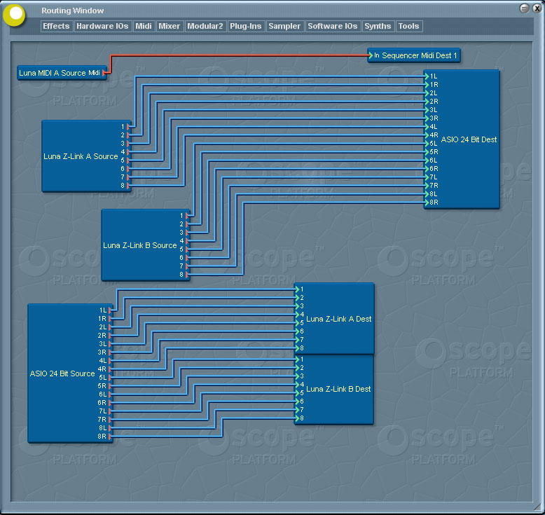

thanks for the prompt feedback guys. my computer tech and i opened up my case and double checked that the ribbon cable and the 4 pin power are connected (even if it doesn't need to be.) Everything is properly seated but still nothing. i have attached a screen shot of the scope routing window. My ASIO 24 bit channels are feeding into inputs 1-16 in Nuendo.
I tried patching a preamp signal into every input on the a16u. Every input channel lights up on the front of the unit, but when i look to nuendo, there is no signal. Could this be a bad firewire cable? they are both brand new cables, and look to be of good quality. Should i reinstall the scope platform and drivers? So clueless guys, any help is much appreciated. thanks again...

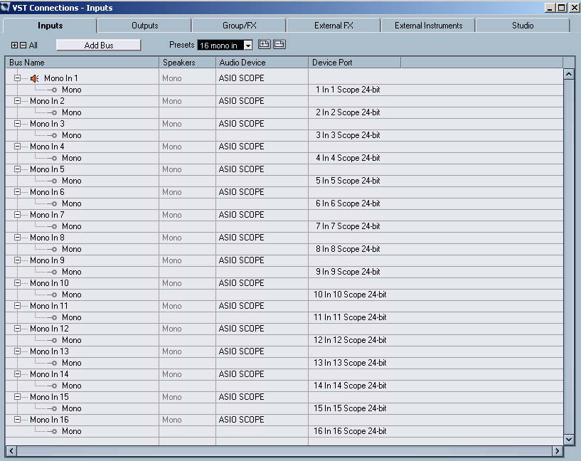

oh and here is a shot of my vst connections in nuendo.

well, not the ideal way test it ... ;)
if you're concerned about the hardware, restrict the environment to hardware and to an absolute minimum of software.
Just connect the Z-Link ports to a virtual mixer in the Scope environment and check which channels carry a signal.
Usually the stuff fails in groups of 8, so an input signal on port 1 and 9 should do the job
Route the respective outputs (physically) back to some other channels (say 2 and 10)
and check if the meters on the mixer display the signal
cheers and good luck, Tom

yes, try the ports with a scope mixer first. and check if the z-link sync led locks to B if you just hook one cable to the z-link port on the adat expansion.
if it does (and the a16U shows synching via z-link), and you have verified that scope is master and the a16u slave (I'd prefer that), the cables should at least be fine.
there is a small chance that the unit mutes completely if not both z-link channels are in sync with each other, but that should only happen if you hook the unit to a non-stdm-coupled bunch of scope cards. still could be an indicator that the ribbon cable might be faulty. you could try to get hands on another luna and hook it via stdm to the other.
-greetings, markus-
