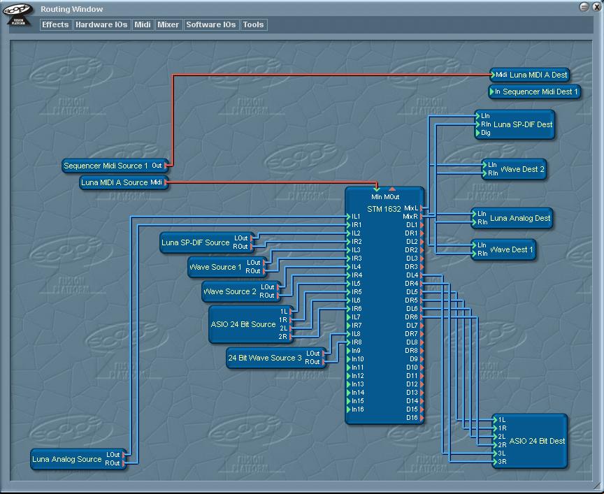

I will upload a picture of the Routing Window.
maybe you could tell me if I did something wrong, or recommend me a different setup.
here:

your asio dest is connected to some odd direct outs. what are you recording there?

garyb wrote: your asio dest is connected to some odd direct outs. what are you recording there?
Recording sounds from movies directly to the host, kinda messy I know...:X
